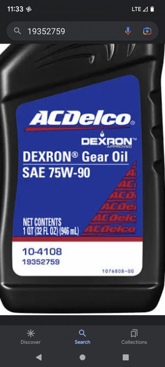

10-4034 was superceded by 10-4108 (19352759) for 2023 model year (per the Service advisor , hope he is correct ) I waited 2. 1/2 hours for this fluid , from the sister Dealership when I was in for 1st service.
Not trying to be a pain in the butt .
FYI for those who want to know
I think the specs are the same
From what I can tell 19352759 (10-4108) superceded 88863089 (10-4061) not 88862624 (10-4034).
This appears to be the new fluid for the non-limited slip differential (V6/I4).
88862624 (10-4034) is the Dexron fluid with the limited slip modifier.
Until I see any evidence otherwise I would be careful putting 19352759 (10-4108) in a limited slip differential.

^^^ this
I'd just stick [no pun intended] with the good old 10-4034, especially since it clearly states "contains limited slip friction modifier" on the box, unlike this new 10-4108 part.
I'll be looking into this Friday morning,as I have an Oil Change at the Dealership , so It 😆 ks like I waited 2 1/2 hours my first service, for them to not do a proper service. I don't have any typical characteristics of no friction modifier additive.

All ZL1s require the friction modifier additive: 10-4034.
