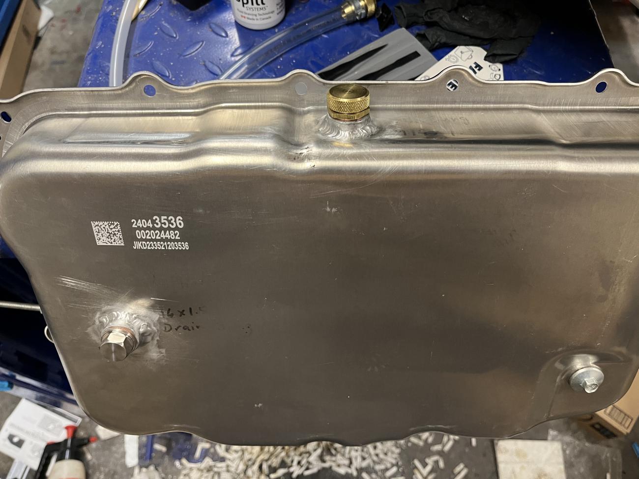

That is why I built a drain and fill pan so I can just go by volume that came out when doing a service because I could never get my transmission up to the old check temperature and there’s no way I was doing the brake torque process
That's pretty cool. Did you do it yourself or have a machine shop do it? I searched, but there doesn't appear to be an aftermarket pan for the Camaro with 10L80 tranny. Ridiculous that Chevy didn't put a drain plug on it considering many track the car and will be doing frequent fluid changes.
