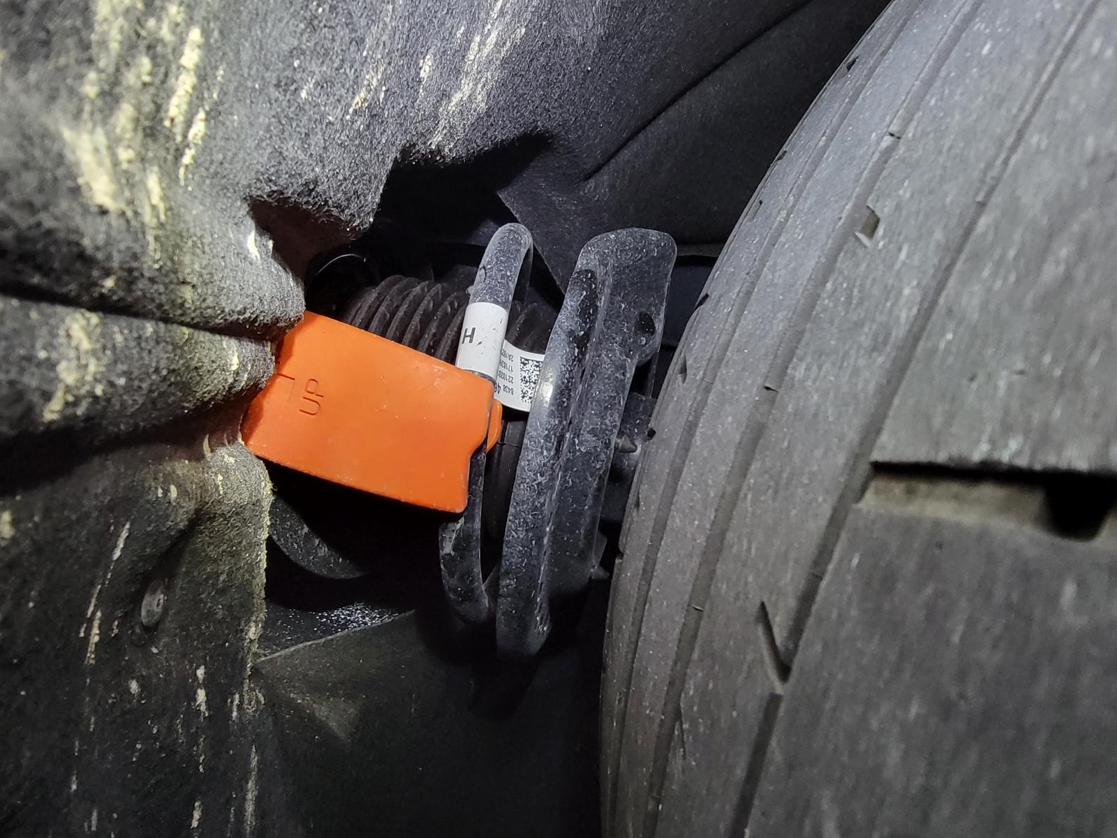

Well, yall were right!!! It is TOO HIGH. The spacers are still installed in the coil springs. 2 years and 3800 miles now. Thanks to everyone for recognizing this and telling me there's a thread about it. I found the thread and read everything to know what to look for. I'll be removing them tomorrow morning. Can't wait to see the difference.

There ya go! Damn dealers are supposed to remove those! Glad that was it... easy fix!

Well 2018ZL1, you were right in your suspicions. The orange plastic spacers were still installed! Here are some pics, LH and RH side. Before measurement at the front splitter apex showed 8.0 inches, after 6.5 inches! A very big difference. The car looks a lot better. I'll post some better after pics when I can get to it. Here's one to start with.
A special thanks to 2018ZL1 and everyone else for pointing this out.

Pointed it out?!?!? Damn thing looked like a Jeep with a 4" lift on it how the hell did you not see those during periodic maintenance or just walking around the car checking things?!
