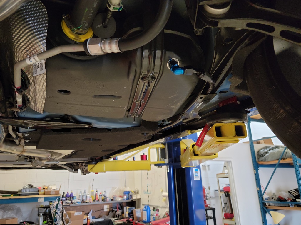

This is why we install a bulkhead fitting in every car that we use an aux pump on.
Mine will be on the rack in the next week or two and we'll probably do this
2020 ZL1LE A10.
100 octane: 1045hp/1055tq.
Old 09-23-2022, 03:12 PM   #22
KingLT1
KingLT1's Avatar
Drives: 2016 1SS NFG A8
Location: 46804
Posts: 7,661
Yep that's the key to no leaks right there.
Thanks for sharing! What bulkhead is that and how does it install? Bulkheads that I’m familiar with have a nut on the inside as well.
I've had a couple buddies leak so that will save a lot of headaches of having to try and reseal it over and over.
Cordes
I’d like to know how this was installed too because you’re right about the nut being on the inside. Anyone have more information on the install of this Cordes bulkhead fitting?
