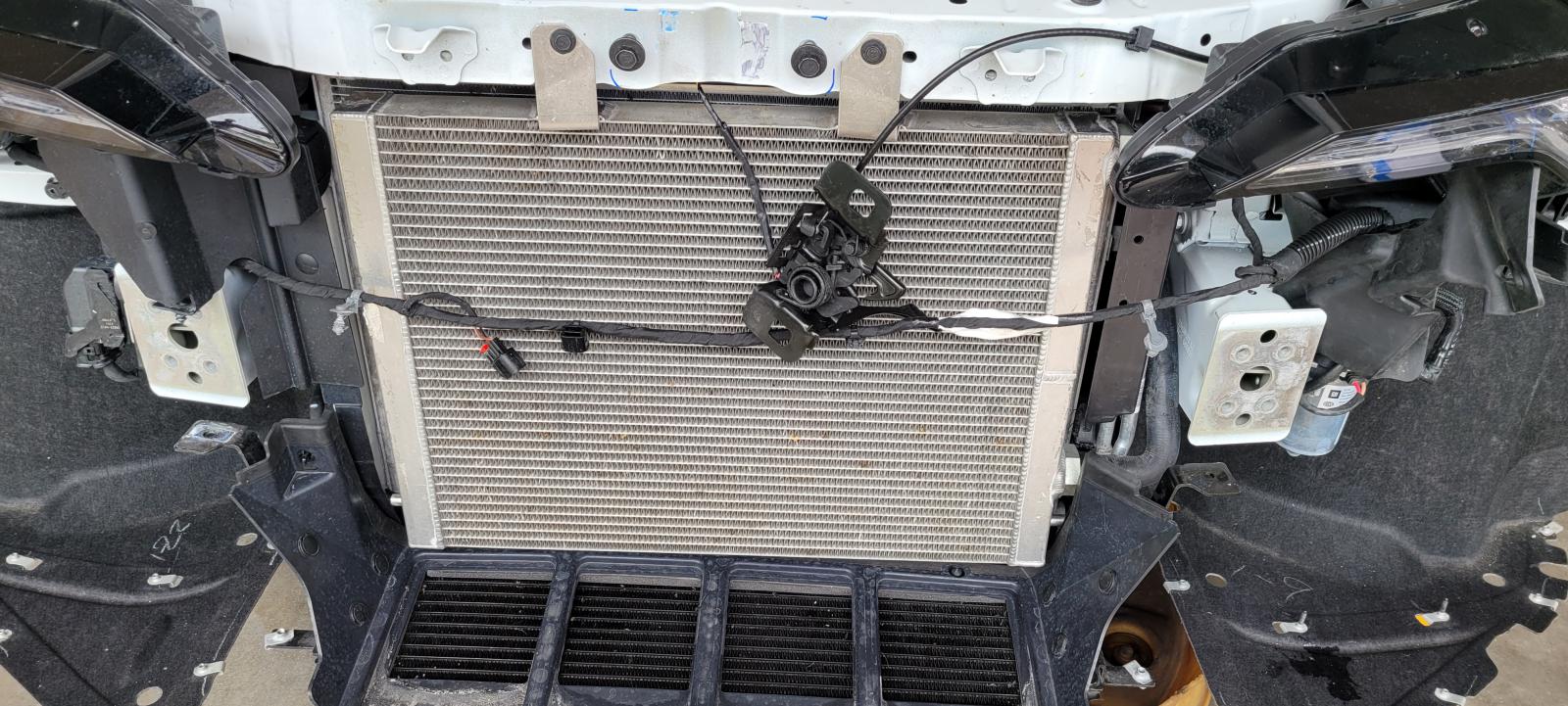

Good Morning, today we hit it again and trying to get most of the install done. Gotta wire the JMS, AFR harness, pull and replace the stock balance with ATI, pull the bumper and install the front LTR (intercooler). Waiting on 4 fuel line connector fittings that's coming from Amazon. The ones you saw in the pic blue plastic release fitting were just the mock up ones used by Mike and we needed to use these until mine arrived so I could test fit everything in the engine bay. Then we can make all the connections and get the blower bolted down. Fingers crossed we have everything needed and nothing got missed. Pretty sure we do but if we are it gives me a couple days to round things up before we get ready to fire it on Wednesday. Still waiting on the Controller, its supposed to be dropped shipped and should be here by Tuesday, hopefully.

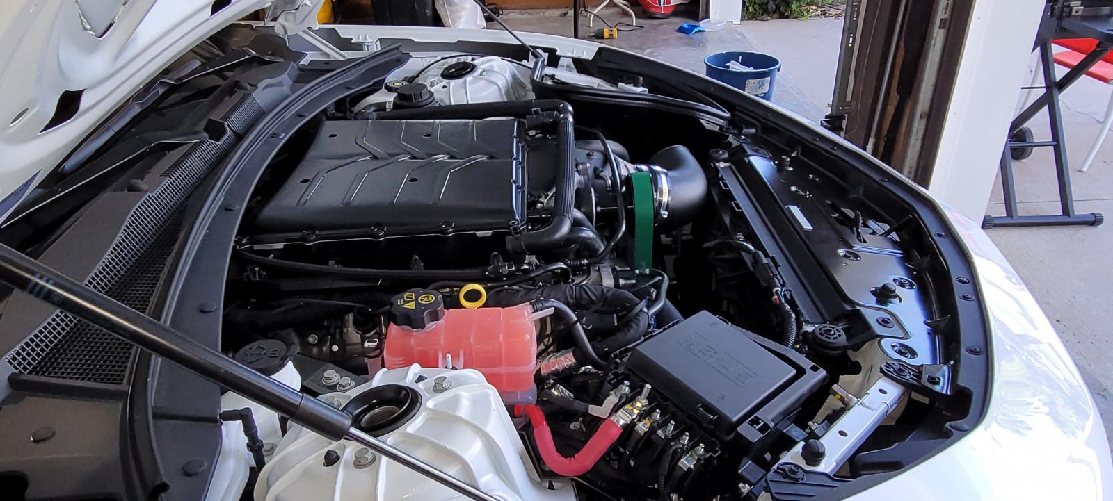

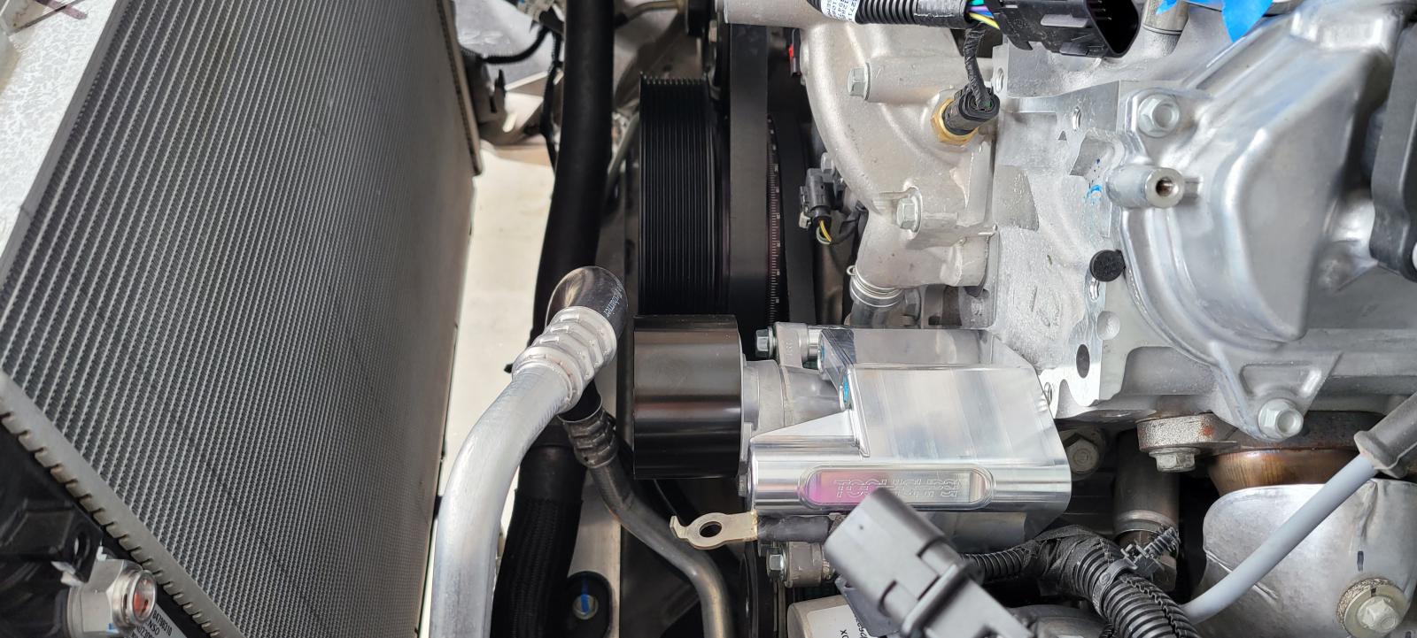

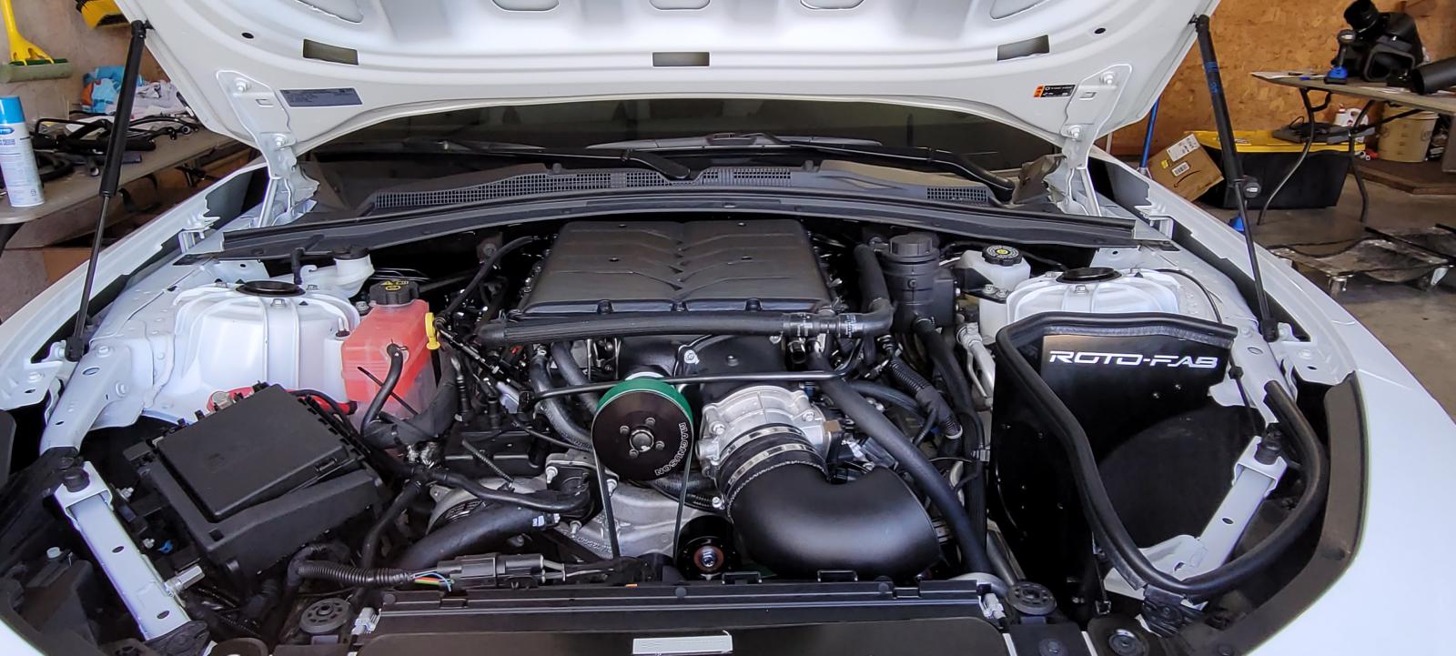

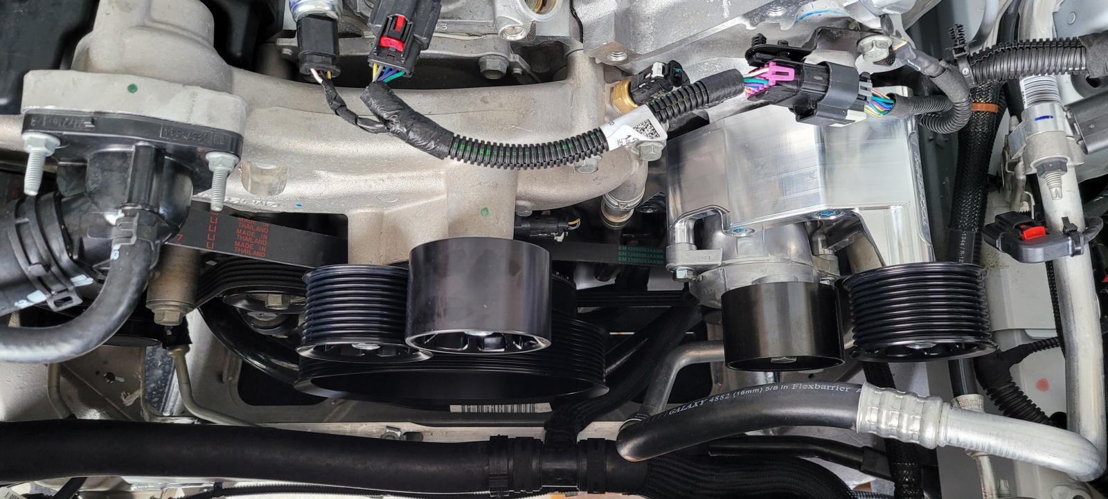

We had a few little issues but nothing Matt and I couldn't figure out. Its just real tight on the passenger side where the brace is from the fender to the firewall with all the fuel lines. The FF sensor takes up a lot of room and I'd probably move it closer to the drivers side. Mike doesn't include fuel lines in his kits, he did this one for me since it was the 1st 2300 Maggie anyone has done. The 91 inch belt fit perfectly, I had good info from MartinLE on the belt he was running since we had similar uppers and lowers. I'll be running the 9.24 10 rib on the lower and 105 upper starting out and we'll see what boost level were are out once we can get some street logs or on the dyno. We hope to run 10-11 lbs. I do have a 98 if we want to run a little more boost depending on the fueling.
