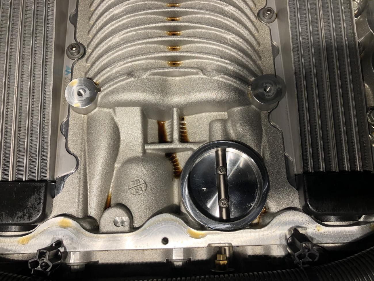

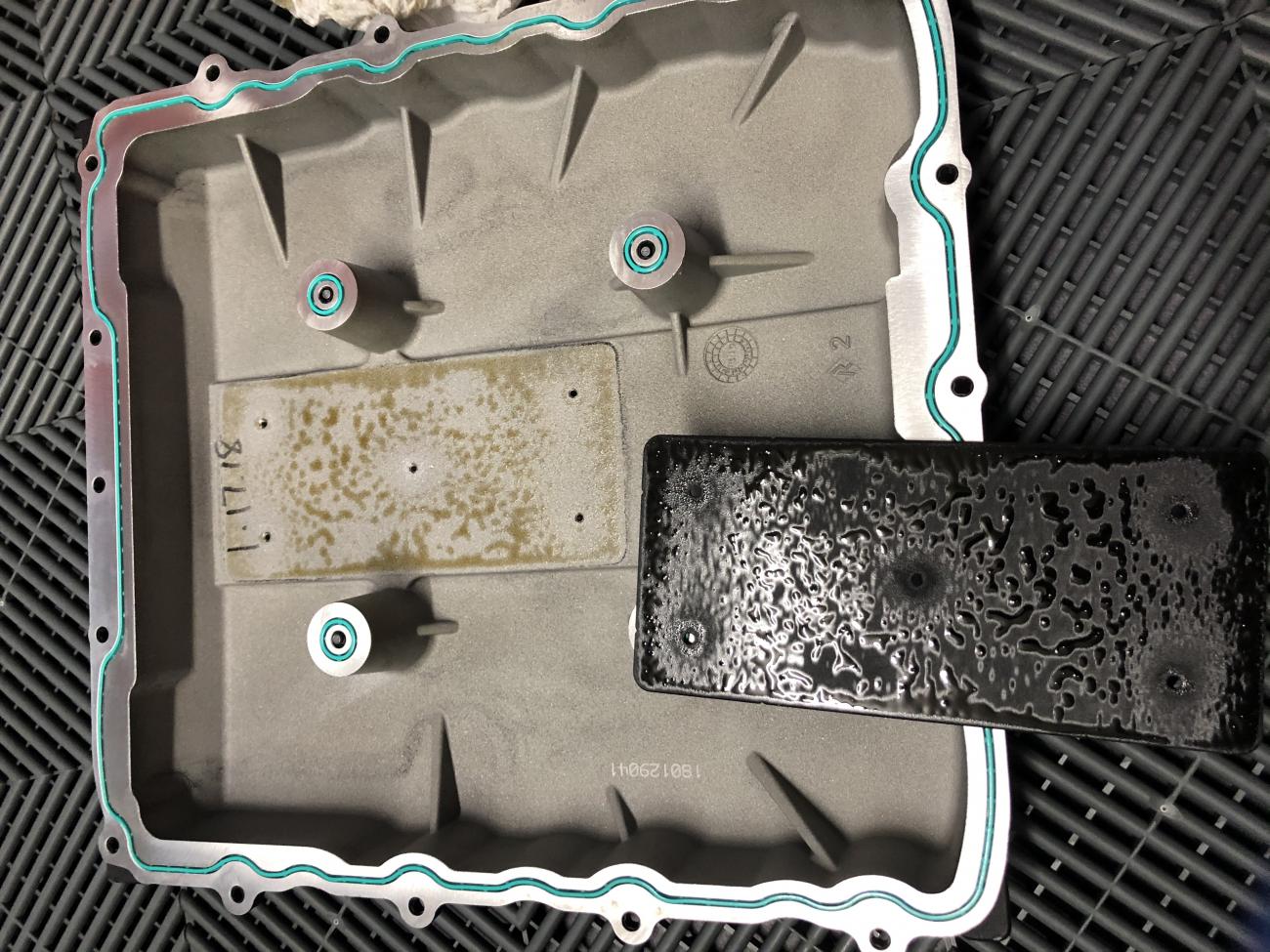

6900 miles on the car & I decided to pull the lid & take a look.
Cleancoupe is offline   Reply With Quote
