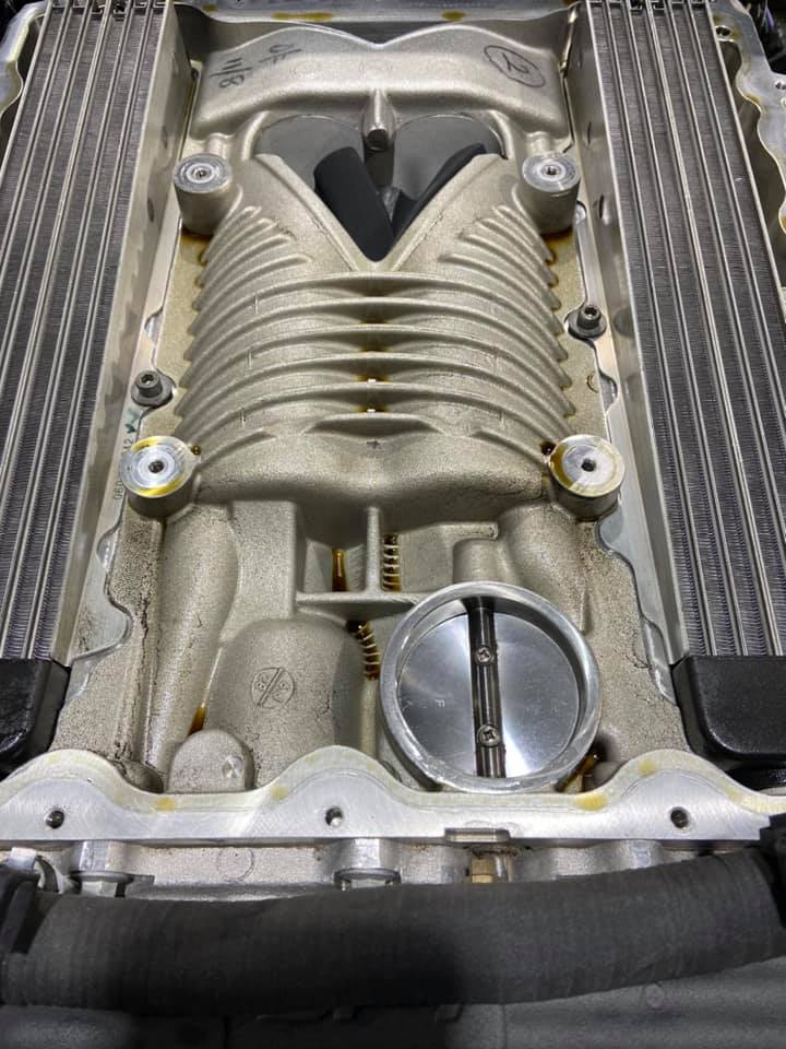

Any photos?
This was posted to the ZL1 Facebook group. It’s a stock 2017 with 67,000 miles and no catch can. According to the owner, the car has not been babied.
Does the oil laying in the bottom of your supercharger look worse than this?

Originally Posted by hawk02 View Post
Any photos?
If that's how oil blow-by looked after 67k miles, we don't have a big problem here.
After a certain point it just gets sucked into the heads. What did you expect to see, a quart of oil sitting on the blower?
Let's see a scope of the valves after 47k with no catch can, as was documented on several Elite threads they look nasty in as little as 5k miles
If that is the case, the only way the oil is going to make its way into the intake ports is by going threw the intercooler bricks fins. The pic posted (as well as the OP pics) doesn’t seem to indicate any oil staining on the intercooler bricks fins unless they have done a really good job of cleaning all the oil out of the fins however there would still be some form of discolouration in the fins (unless the pics don’t show the discolouration, sometimes things look different in the flesh vs in pics).
The oil is obviously being drawn up via the port in the valley plate, either going threw the rotor pack and coming out the discharge port or bypassing the rotor pack and coming up out of the bypass valve. That said, the oil still needs to make its way threw the bricks fins to get into the intake ports, surely there would be witness trace of oil residue in the fins if this is the case....no? For the amount of oil that’s in the ports, there would have to be a fair amount running threw the fins.
