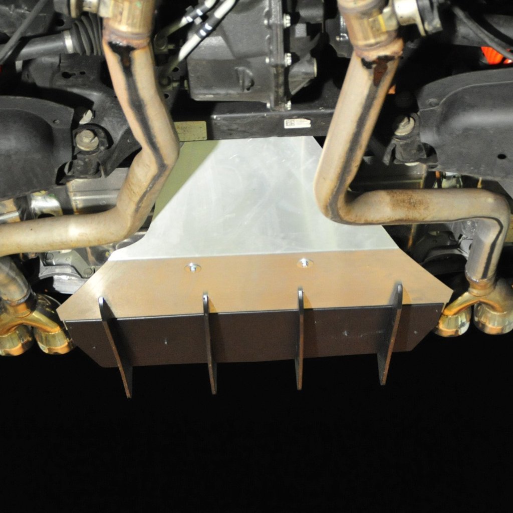

I bought a cheap eBay universal diffuser and some extra plastic sheet. A little cutting, riveting, and "self clearancing" from the exhaust to make it fit. It's far from pretty or perfect, but it's not a huge gap back there.
Definitive answers? No. You'd need wind tunnel for that and AFAIK nobody has done that in a 6th gen and published the results.
Theoretically, dead air pockets under the car could increase air pressure under the car, increasing lift and reducing rear-end traction. The car has aero panels for a reason. But at anything under 150mph you're probably OK as long as you have something in place of the suitcase like a pair of A/M mufflers.
I would be more concerned about lift at high speed (1/2+ mile runs, etc.) if the car was straight piped or nascar piped, than worried about sub-100mph drag on a road course track.
Almost all road courses will be north of 100mph, probably multiple times per lap, but mostly agree with you.

Oops caught me with a typo... I meant 150 but yeah I could see taking advantage of a void created by suitcase removal to reshape the rear diffuser into something that could provide a lot more downforce. Making lemanade from lemans as it were

If you're concerned you can get a diffuser kit like this from ZL1 add ons, price is very reasonable too.
I will probably get their diffuser for stock muffler.
