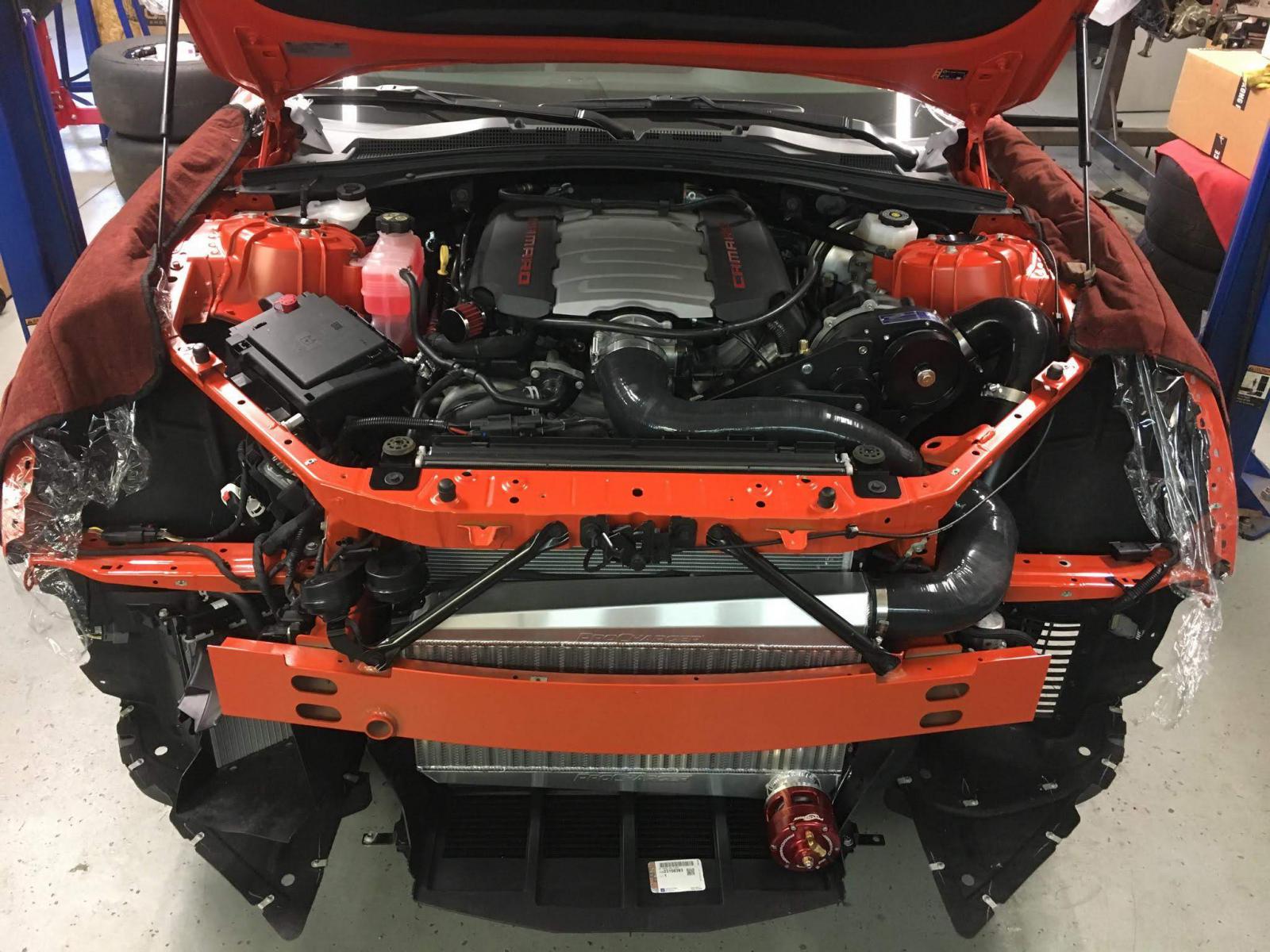

Got it back from the installer/tuner. The car only has 1,600 miles on it. The pulley on the Procharger is stamped 4. 50. I'm assuming that is 4.5? It made 558 rwhp and 497 rwtq. Car is a totally different animal. It just doesn't stop pulling. 0-100 happens in what feels like 5 seconds...lol
It sounds like a jet engine is in my motor compartment...very cool..
Really impressed and happy with the results.
Dyno sheet is posted....does the 0-60 (psi) at the bottom of the sheet mean boost?

Unless there was a connection to the ODBII port, I don't see how it can be boost. Boost which is a measurement of restriction should be about 8 PSI, I don't know for sure as the engines I have are all built (less restriction), so a built engine will see less boost for any given pulley size, any given RPM, say 1 to 2 PSI less boost; but the built engine will be making more HP.
That said it sure does look like a boost curve. 10.4 PSI is a lot of boost and it does look like there is a hick-up of some sort and maybe it is knock retard, as it was on its way to making 560 whp by 6100 RPM.
