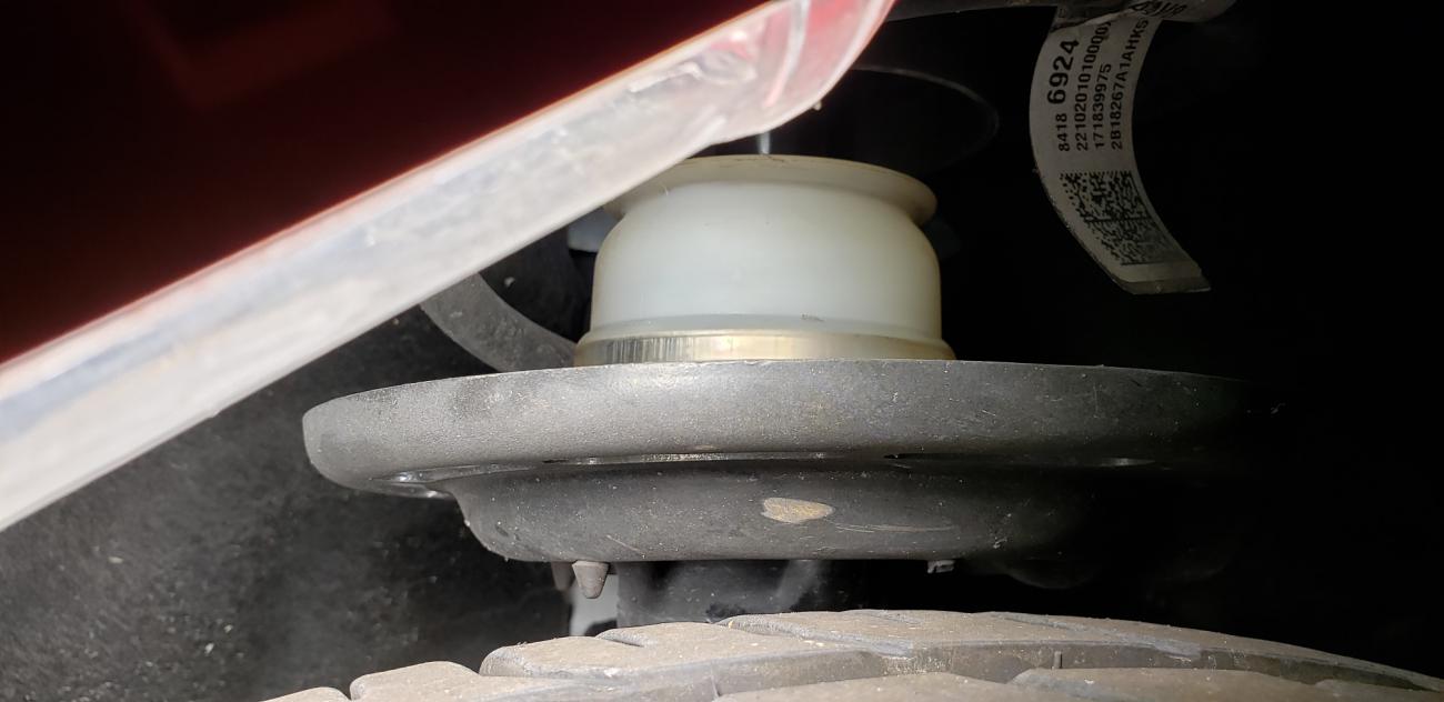

here is a 305 30 20 on a 10.5 strut clearence is way plenty with very little poke. It passes my humpey test no problem off set is 25. I feel fine going to an 11 rim with apporiate off set here as I can get near half inch between the tire and strut closes point, im talking down on the back side closes point not whats in this pic. And its about 7 mil further in from the fender than the same on the back so. I really see no need to go that short unless rim width comes into play but the 305 30 20 on a 10.5 is a brezze
