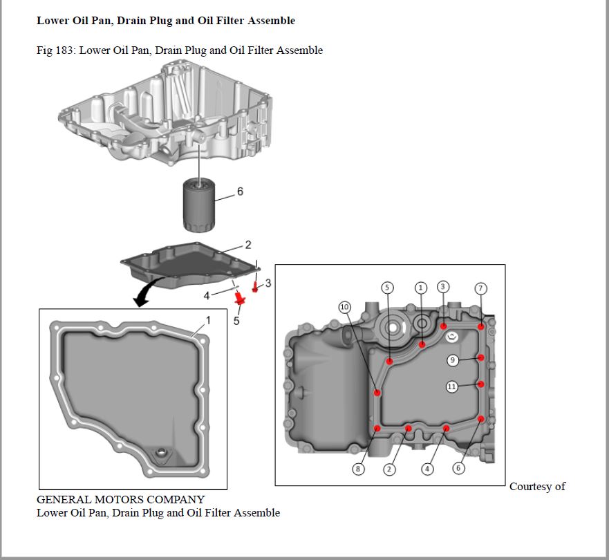

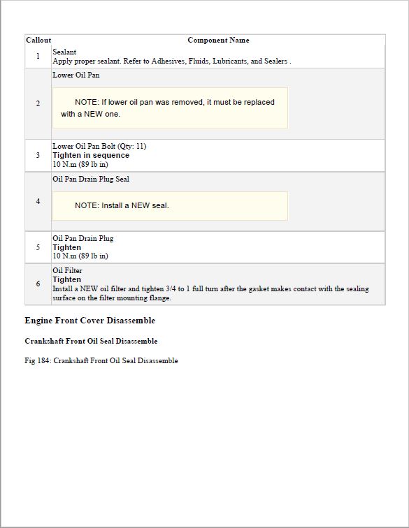

Originally Posted by cmitchell17 View Post
I don't think so I think they just skipped tightening a few of them, mine was built in March 2017. If you just get under there you can reach up and feel if the screws are loose or not. Be careful when you tighten them up (aluminum threads) or use a torque wrench to 18 ft lbs (#2 in picture), back 2 screws to 106 in lbs (#3 in picture) follow the sequence, some bolts you really won't be able to get a torque wrench on unless you have good tools but do the best you can:

Old 05-19-2021, 10:40 PM   #16
cmitchell17
Drives: 17 2SS, 8L90, Cam, Heads, E85
Location: US
Posts: 1,213
