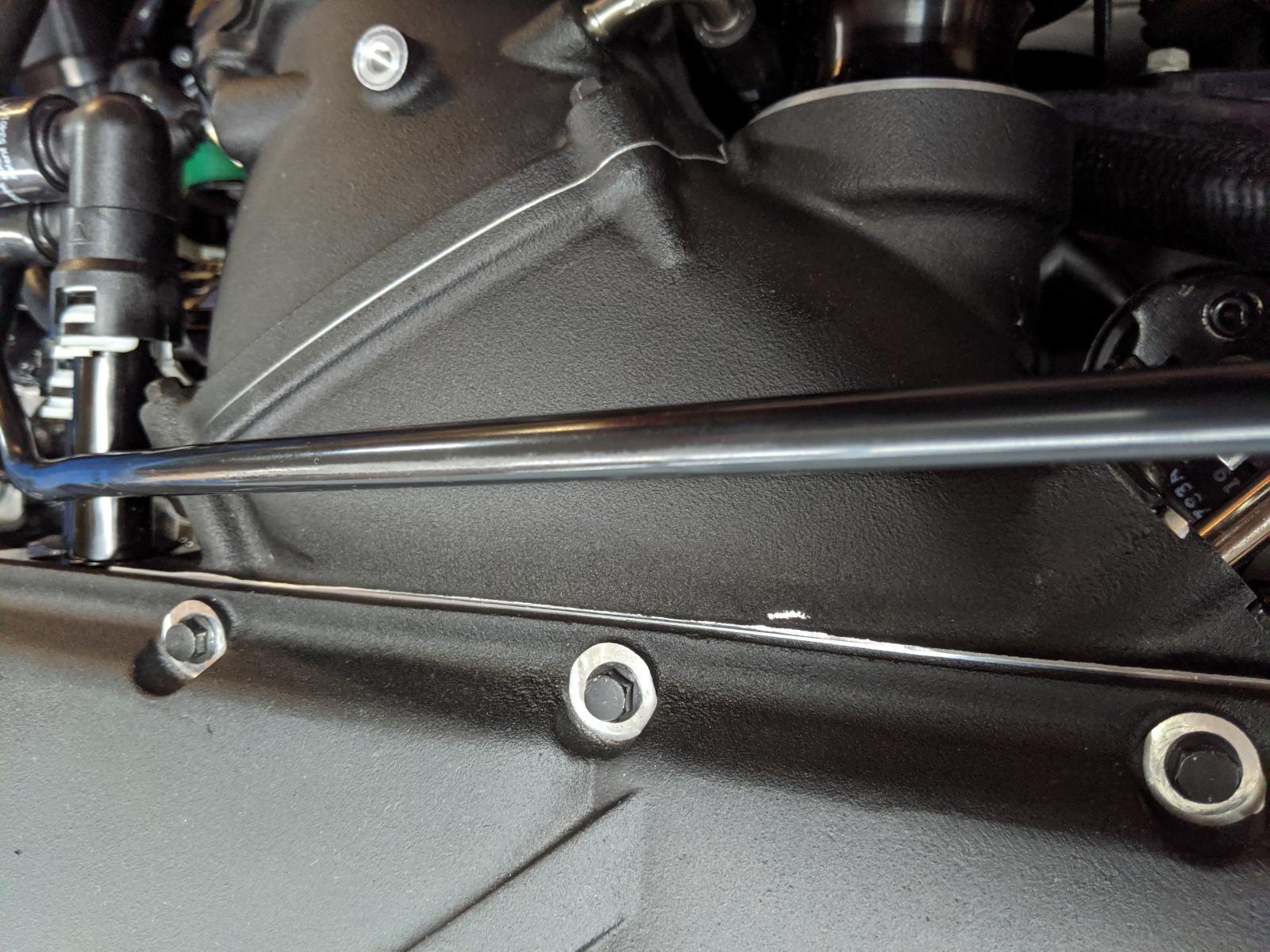

Far as fit and finish. Well they both are good imo. On the C7Z kit there was one PCV line that had the wrong quick connect fitting. Other then that pretty good. Whipple finish is much better. The Maggie already had a scratch on snout right out of the box.

Sounded great. Could you tell what had scratched the snout? Packaging?
Not sure but here is a pic.

I've not seen a scratch like that one from just packaging so don't know what could have happened. Sorry about that. Ours and the Whipple's do a have a different finish. Whipple is a little smoother for sure. Looks good.
