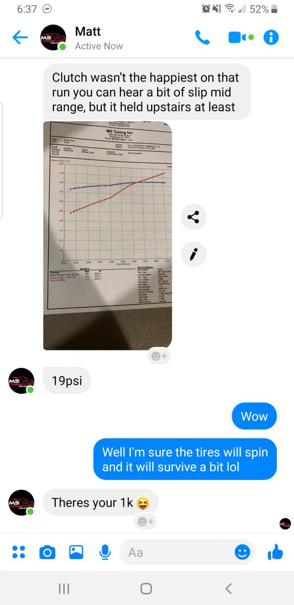

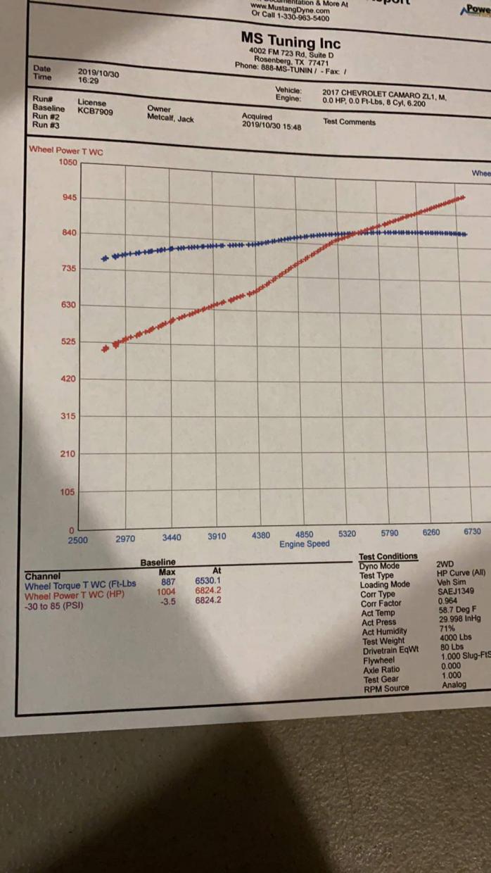

Tuner just sent this.. I had to go port since proven! All Kroger's e85 no meth..
