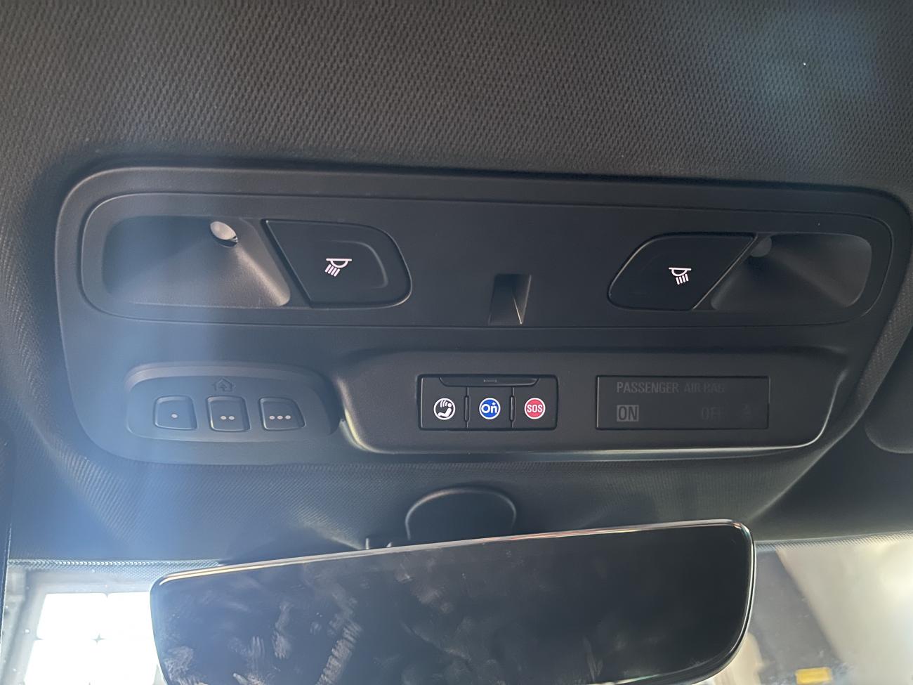

Universal homelink from Amazon. Little nervous cutting into my upper console and itt came out pretty good I think. Also used the Gen5Diy’s extra power supply from my radar detector kit to power it.
Very nice install. Looks factory!
Definitely looks factory. Please provide install details.
How did you remove the overhead cover?
What did you use to make the cutout?
How did you wire it?
Thanks
Removed the overhead console using plastic trim tools. There are 3 tabs one in the center (back side of console) and one on each side that you can see in the picture above. They don't give much slack in the wires so disconnecting all the harnesses was a bit of pain especially the one closest to the windshield.
Once you have it out you will notice more tabs that allow you to separate the the console into two pieces which makes accessing the area to cut a little easier.
I used a Dremel tool to cut the hole and also the piece in this picture to make it fit. The HomeLink part fits exactly in the compartment shown after trimming this piece. I then marked the edge with the harness as a reference point when it was removed. then placed the button piece upside down so I could mark the tab location then using the supplied foam gasket/template I traced out the hole and cut it out.
The kit I got came with multiple foam gaskets which was good cause I ended up doubling them up so it was a nice tight fit as with just one there was a little gap between the button housing and the console.
I wired it up using the Extra power lead on the radar detector harness kit I purchased from Gen5Diy. It is using ignition power so the car does need to be running for it to work.
Let me know if you have any other questions as I'm always happy to help. Just which I would have taken more pictures of the hole I cut as well but I had already installed once i thought about taking pictures.
