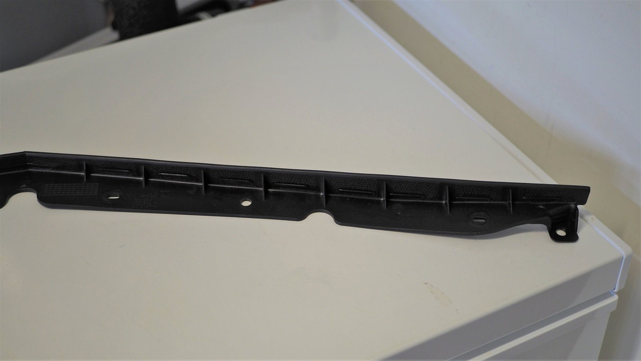

I'm reviving this thread for a reason:
The dealer failed to install the center air dam on my 2023 ZLE. I could do it myself, but would need to obtain the pop rivet and tool that are required in addition to the 12 screws.
But I notice that URBAN LEGEND's photos in this thread show that the rivet, which goes exactly in the middle of the air dam (the point of the triangle) was omitted on his apparently with no ill effect. Doesn't look like the air dam is sagging at all. So I'm considering doing the same, which would also make it easier to replace the part when it wears out.
The dealer failed to install the center air dam on my 2023 ZLE. I could do it myself, but would need to obtain the pop rivet and tool that are required in addition to the 12 screws..
Thanks for bringing this up. I just picked up my car and found the same piece in the trunk with no plastic wrap or instructions. As you indicated the dealer failed to install it during PDI, that is probably why no mention of the piece in the manuals. I just looked at the plastic piece and under the front of the car. There are eight fasteners that will need to be removed then reuse those to install the plastic aero piece. No rivet needed. The two end bolts are 7mm and the six other bolts are T15 torx. This is an easy DIY job maybe 5-10 minutes.
If you look closer at the enclosed pix, you can see this was installed prior, most likely during original assembly. The washer indentations from the bolt installations are clearly visible. Maybe it was taken off for shipping and the dealer failed to re-install it.

Thanks for the replies! Saves me the trouble of either installing a rivet or going back to the dealer. Plus no rivet means easy replacement if the part is damaged.
My air dam shows no signs of being previously installed.
