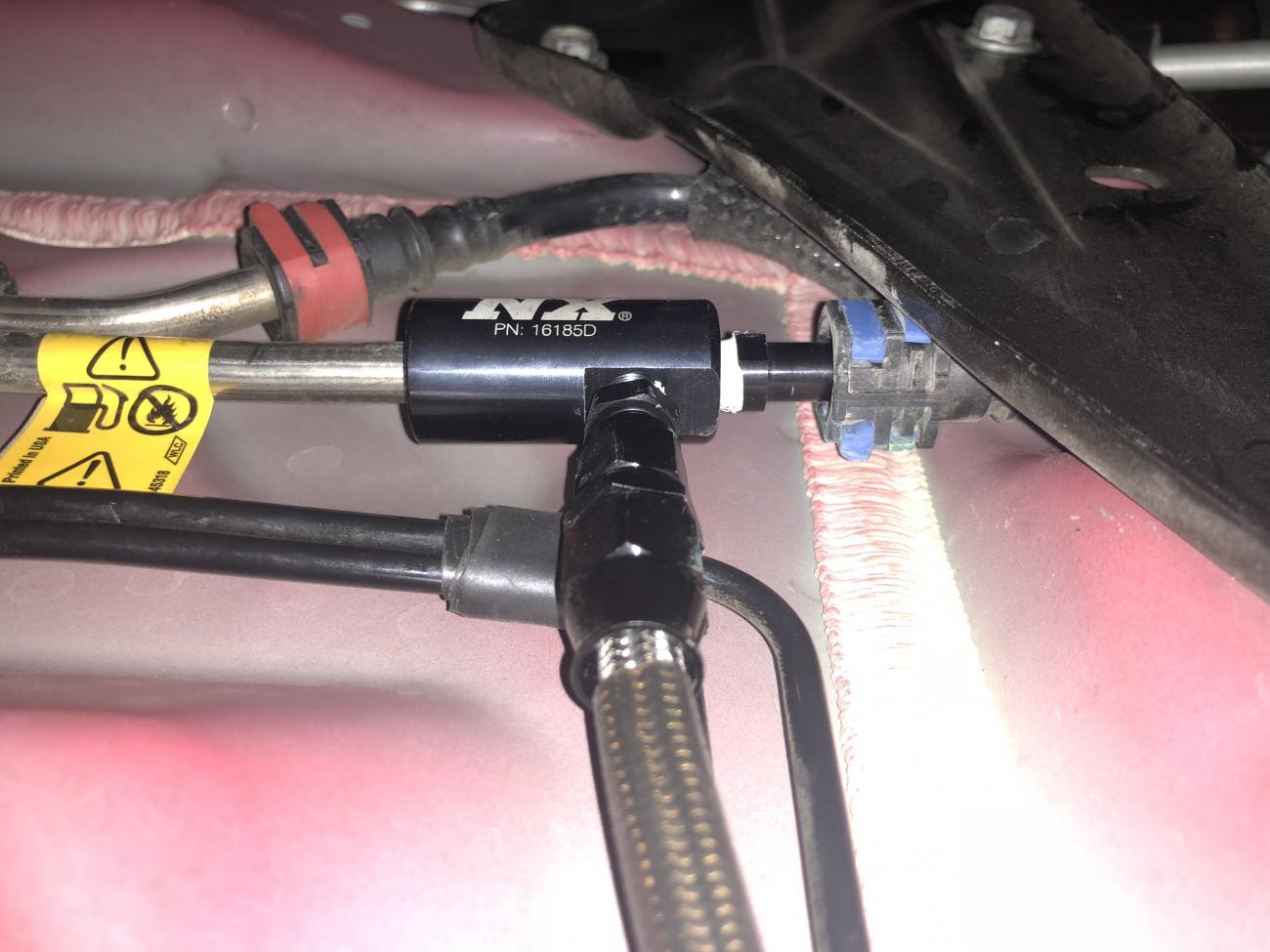

This is my tap for the fuel feed to the surge tanks. You do have to find a way to return from the surge tank to the main tank.
