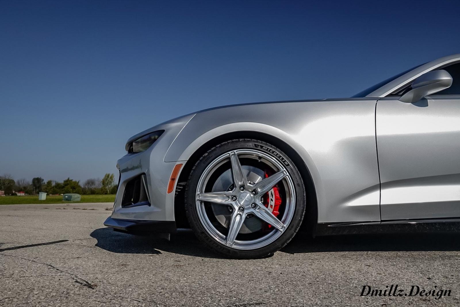

Originally Posted by hawk02 View Post
Michelin Pilot Sport 4S on HRE FF04 wheels. 305/30 rears and 285/30 fronts.
Nice setup. I was looking at those same ones.

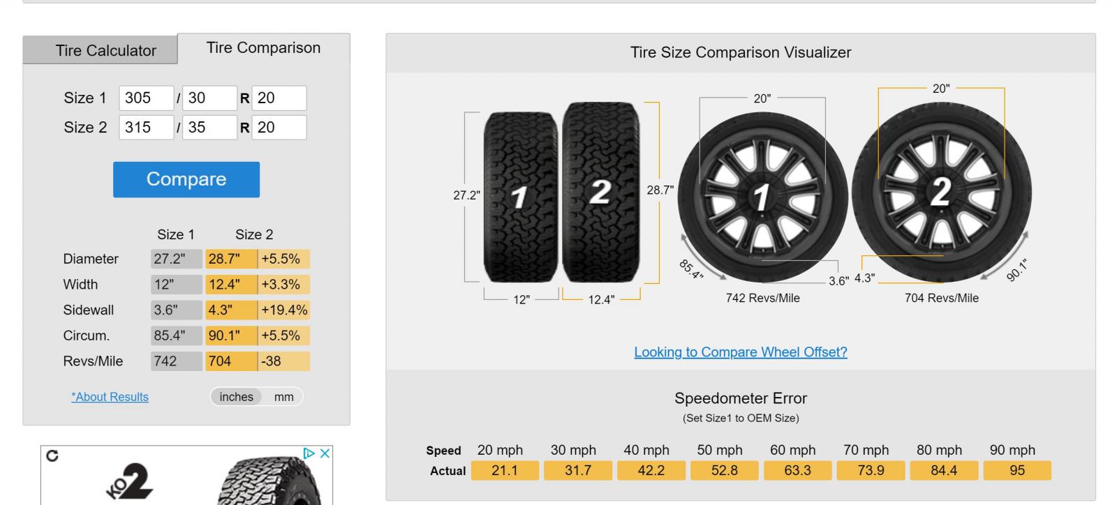

Originally Posted by unavailablezl1 View Post
You are talking only .5 mm each way from center. You won't notice even looking at them. You should not have any problems.
Just keep this mind...
https://tiresize.com/calculator/
ZL1 Front = 20-in x 10-in
ZL1 Rear = 20-in x 11-in

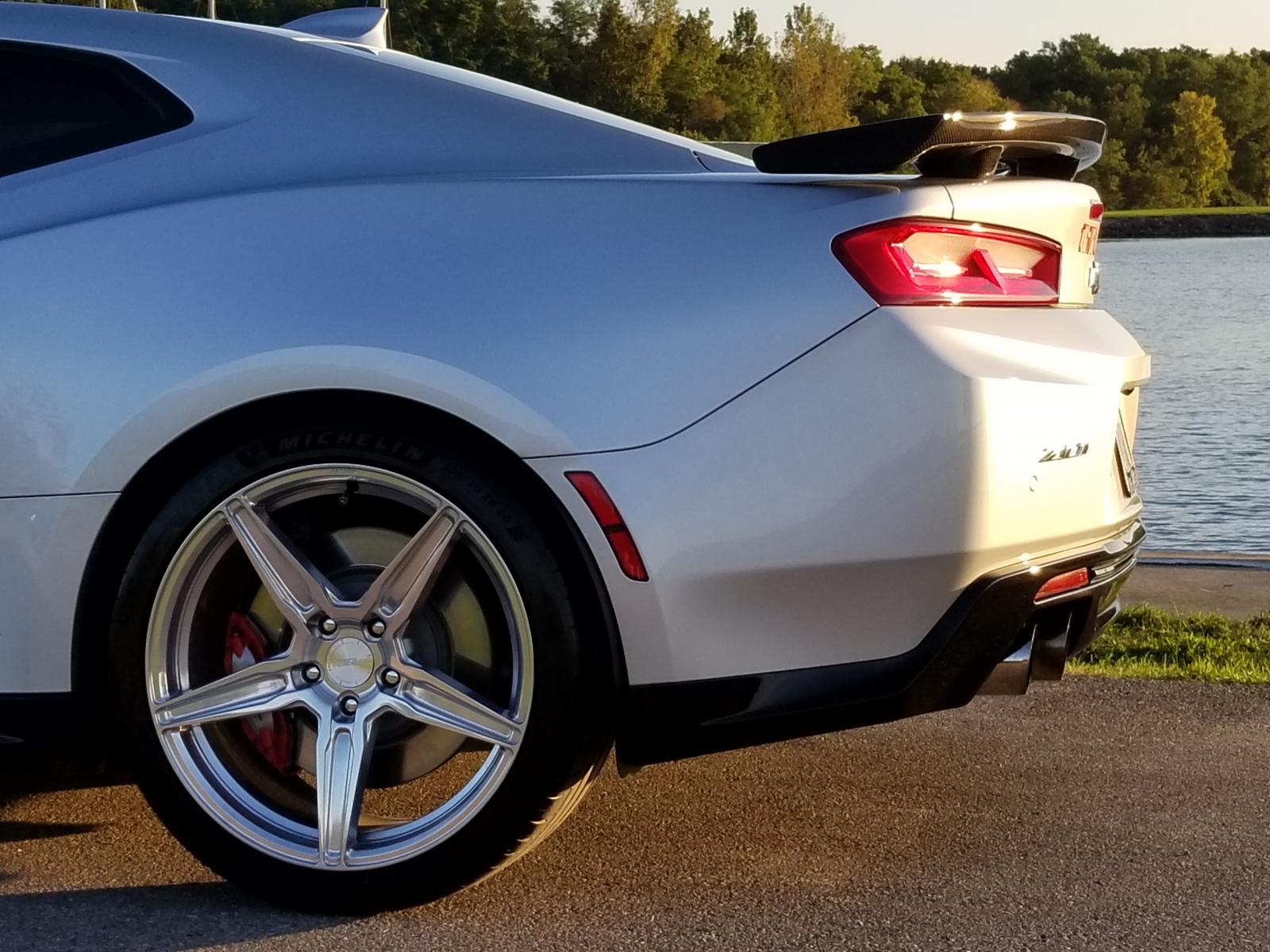

Ok got them mounted. WAY better look and ride. Only drove 9 miles but these things are the best. Big improvement in ride quality. I’m not worried about handling or anything because all I do is drag race and I have another set of wheels/tires for that. I just wanted a great cruising tire and these are them!
Here is the pirelli 305/30 rear. Looks stretched and short
Here is the Michelin 305/30 rear. Way better fit. More meat
Here is the Michelin 285/30 front

Yeah they look great. I'm going to get a set of PS 4S in ZLE sizes. I'm way too cautious / not confident on the stock good years.
