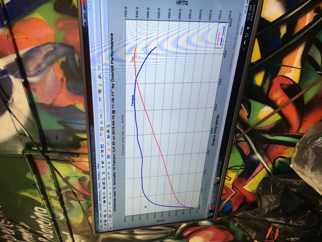

Here is another pull.
The torque number is more realistic but still at a high rpm.
A touch over 600 torque at about 5,000

For starters, go kick the dyno operator in the shins... first clue in something wrong is the dyno chart data...
HP = torque * RPM / 5252
The torque and hp graph lines will always cross at 5252... this one shows to be at 5750, or about 500 rpm high... software, calibration, operator knucklehead, something isn’t right... toss those graphs in the garbage...

Why are the left and right scales on the OPs chart different? Is that why the cross section isn't 5252?

My previous question still stands....my dyno chart is the same, meaning a different scale for the HP and TQ. My chart has TQ on the right and goes up to 550. the scale on the left for HP goes up to 650. Therefore, mine do not cross at 5252 either. Just saying...

I spoke with my tuner, and he stated, the values can be set from one side to the other at any scale he desires. This can cause the lines to cross at different “rpm” values. Say at 5750 as shown above. He did state however, on the planet earth, with our known physics, the torque and hp will cross at 5252.
So, he said you can take a ruler and align it straight up at 5252 rpm and you will have the same hp/tq value at that speed/rpm.
This is something he has no need to do, and therefore it has never come up in conversation between us... He said this might be more commonly seen in motorcycle shops or shops where diesels are tuned, where the power plants may have wildly varying hp/tq numbers... say a diesel with 500 hp and 1400 ft/lbs of torque... to get them on the same sheet without flattening one to the point of no variation, the scale values are varied...
I hope this alleviates some stress, and I do apologize for the less than complete response earlier...
Please don’t go fire your tuners or call them out like I did above...
