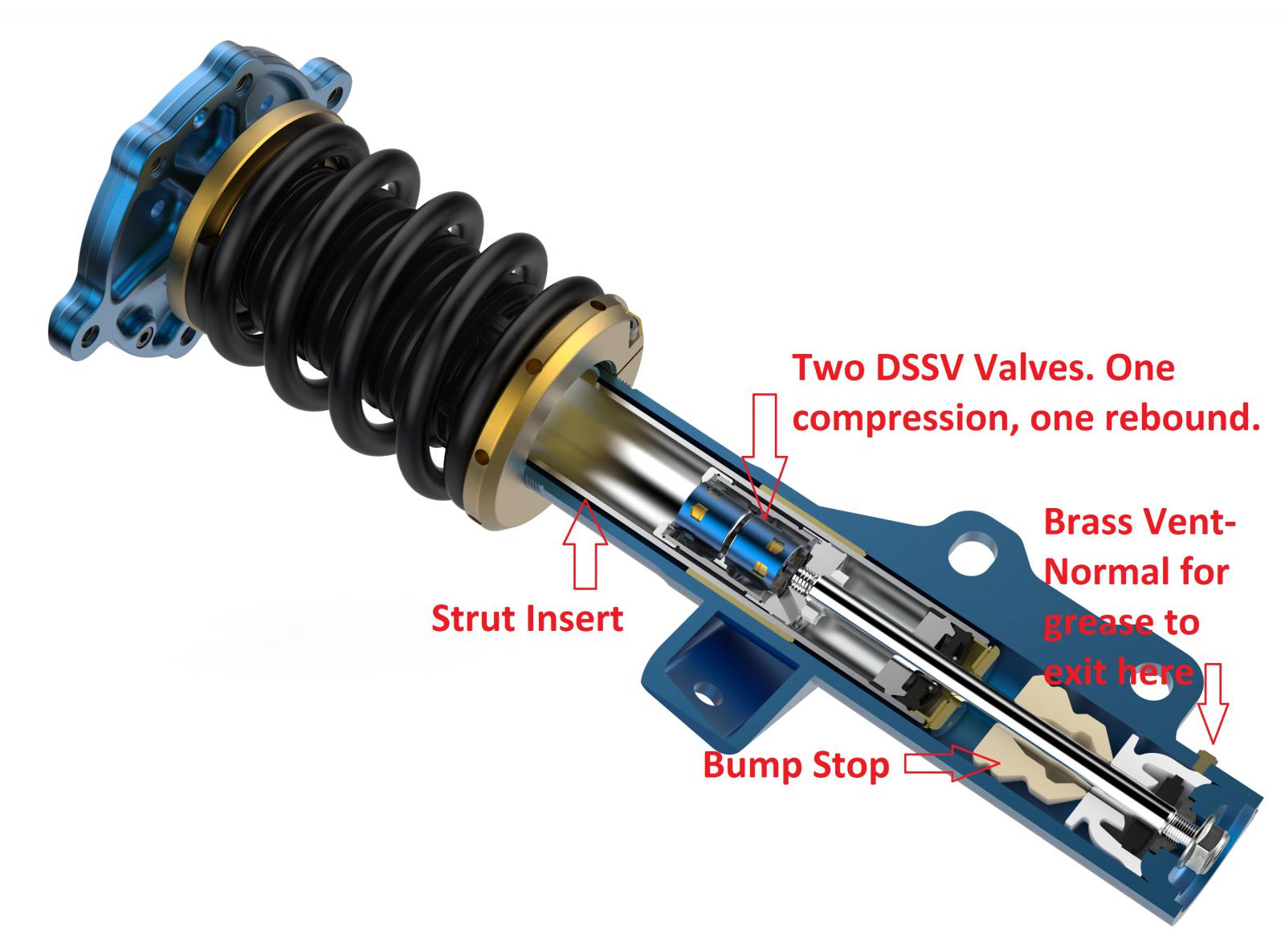

Originally Posted by 2018zl1-1le View Post
Can that nut inside the strut be tightened I think mine is loose. And if it can how would I go about tightening it?
No, the nut is too far deep, the entire insert would have to be disassembled.
The problem could also be the upper strut mount ball and socket. There's a nylon bushing that is part of the ball and socket and it gains clearance.
Check the small nut at the bottom of the strut also, sometimes they can loosen.

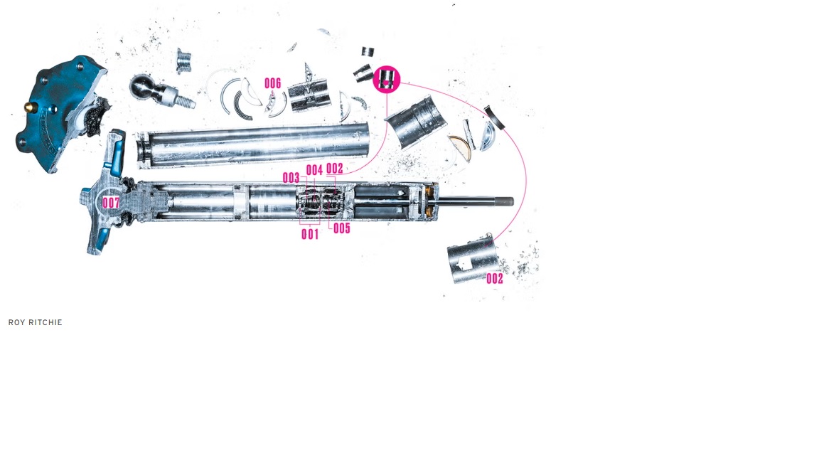

These DSSVs are a strut insert type of shock. All the valving is within the insert, the insert moves within the strut body when the suspension is moving. The valving is attached to the shaft which is stationary.
You could dismantle it and remove the insert. But, looking at the pic I posted above I believe that cut apart piece is of the strut insert alone. Not the entire strut assembly. The nut in question looks to be part of the strut insert and to get to it may require getting into the gas charged part of the insert.

When you remove the nut at the very bottom of the strut this frees the insert from the strut body. But you have to remove the tension form the spring also. I think there's more to it than this. I am at work right now and I have also disassembled a damaged ZLE DSSV. I don't recall all of my disassembly and I have more pics at home.
"KEEP THE FAITH"-Fbodfather

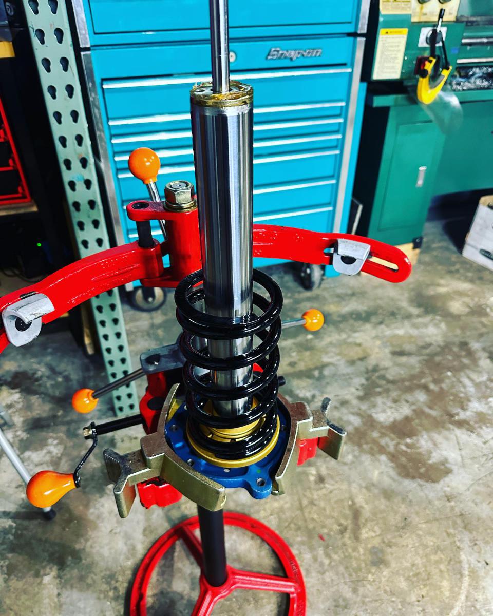

Pic I found on IG. Shop was installing lower rate springs.

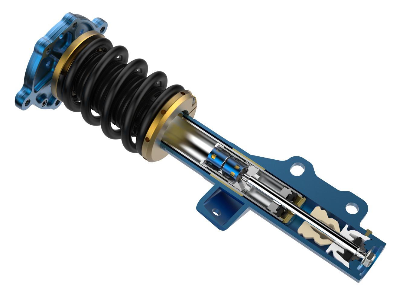

Attachment 1158240
Hello guys -)
its possible to change front springs ??
i just want to get 2cm 0,8 inch on the front and rear lower than stock the car looks like a truck.
I will have the original springs compressed.
Marozl1LE is offline   Reply With Quote

Yes. You have to remove the nut at the bottom of the strut to allow the entire strut insert to be removed. Then the spring can be swapped. The upper strut mount (camber plate, upper spring perch) will come with the strut insert.

Yes. You have to remove the nut at the bottom of the strut to allow the entire strut insert to be removed. Then the spring can be swapped. The upper strut mount (camber plate, upper spring perch) will come with the strut insert. See the pic in post # 21.
