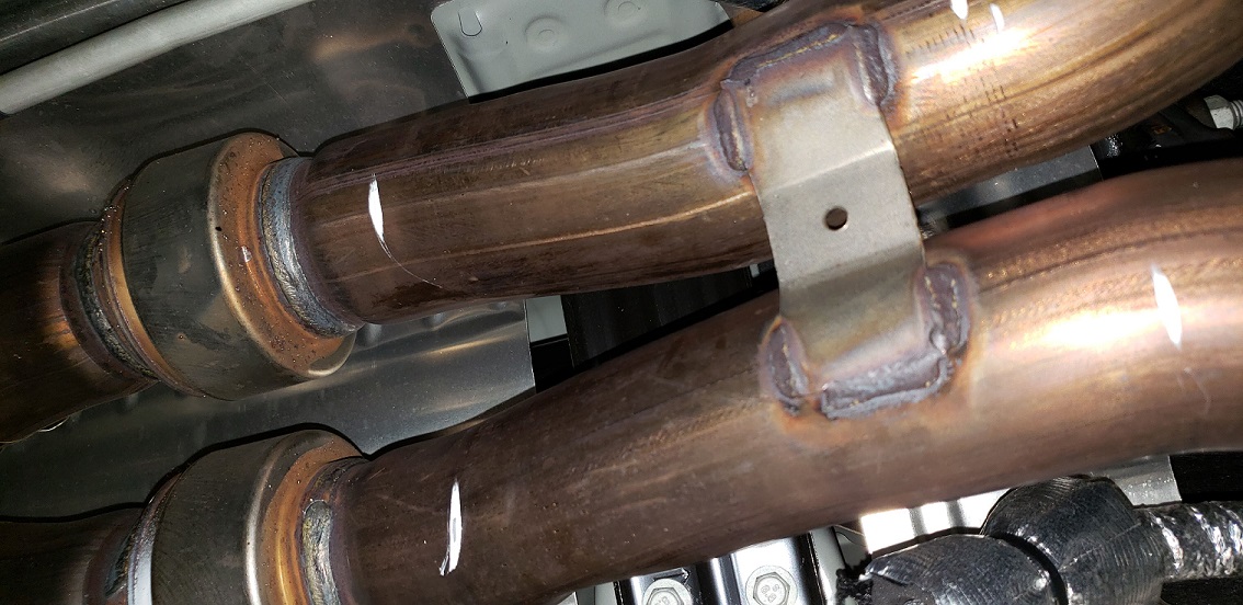

Pic attached of spot being talked about. Exhaust flow is from right to left - flex joints are towards the rear of the car.
There's really not a straight section of pipe in there. In front of the the pipes bend pretty quick towards the sides of the car into the secondary cats.
Cutting the brace and grinding everything smooth would yield the most workable length. I cut the pipes farther down - just ahead of the marks by the flex joint. The Vibrant clamp is long enough that it extends past the factory dimple in the pipe to clamp on the round section.

Yes, because there's just not a good section of straight pipe. I think you're better off using a Vibrant clamp.
