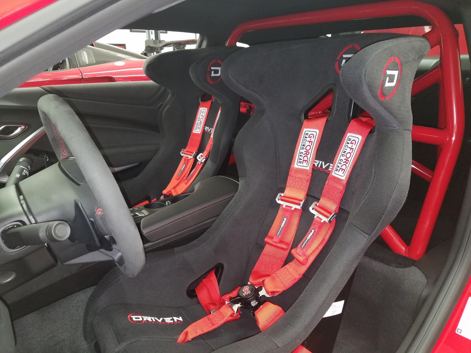

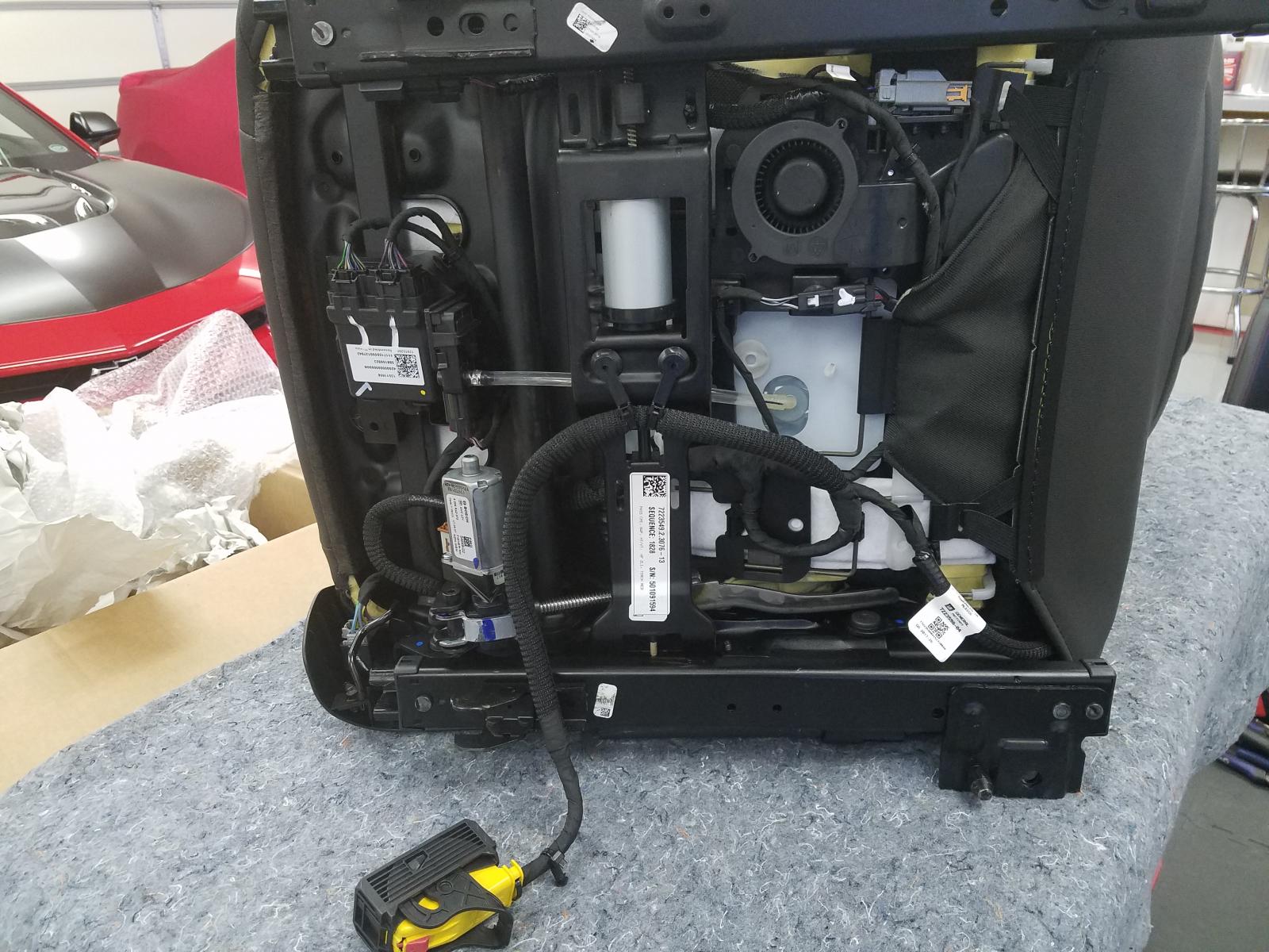

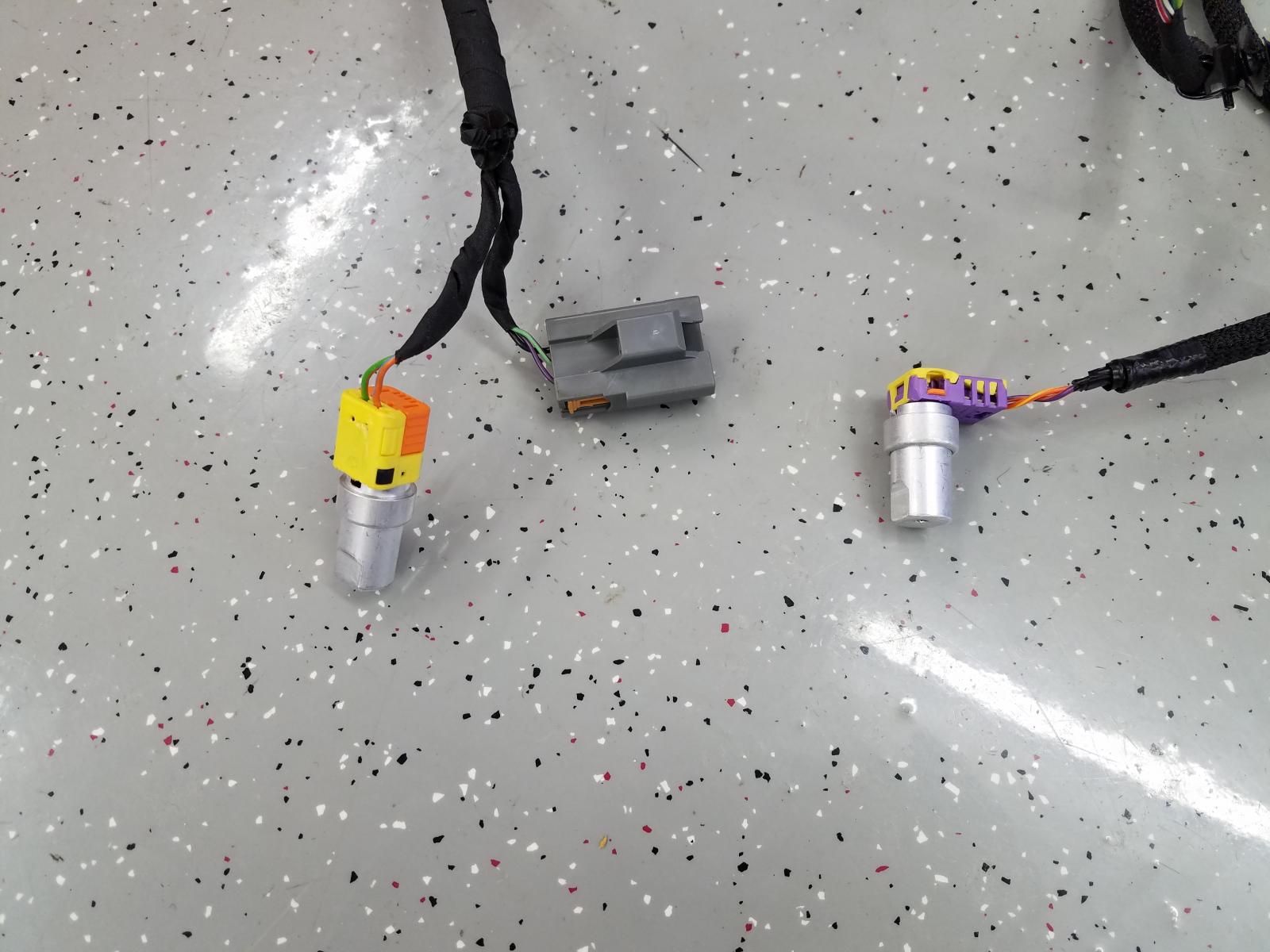

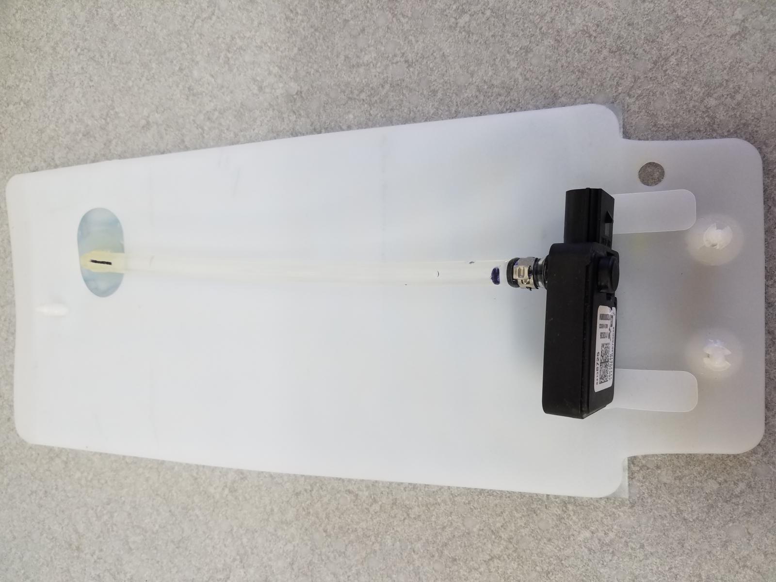

Ok guys.....I got a lot done.....have the seats in....but still have an Airbag light.....
Here is what I did:
Removed factory Recaros
Stripped the factory wiring harnesses from both seats (not that hard, just takes a while, painstaking.....)
Removed the Passenger Seat Occupancy Sensor (comes out quite easy from the top side by releasing the seat bottom leather and cushion)
Plugged in two resistors for airbag and seat belt sensors in each seat.
Plugged in the Passenger Seat Occupancy Sensor.
Plug in both harnesses (Driver/Passenger)
Installed my new Driven Race Seats with Planted Seat Brackets (unfortunately....they are not "Planted"...I had to modify them to get them secure)
LOVE the seats! Frustrated that after all that work I couldn't defeat the Airbag light! I'm guessing it may be position sensors. Have an appointment to get the code checked to see if that provides more details on what is throwing the code. Will let you know what I find out.
Tons of pics below!

Well boys.....I couldn't defeat the Airbag Warning Light with all my work on the seat wiring harnesses.
As per my post below....stripped the wiring harness out of both seats, replaced the airbag and seatbelt sensors in both with resistors, pulled the passenger seat occupancy sensor out of the seat and plugged it into the harness, after I had both harnesses installed and the seats in - connected the battery and after I fired up the car.....Airbag warning light came on...
Had the code read at the dealer this week, code is:
B0080-04 Seat Position Sensor Circuit Open
As a result, I'm just going to pull both wiring harnesses out of the car and dismiss the warning every time I fire up the car and ignore the light. Given the cage, the racing seats, the harnesses I don't need the airbags anyway, I was just hoping to defeat the nuisance of the warning message/light.
