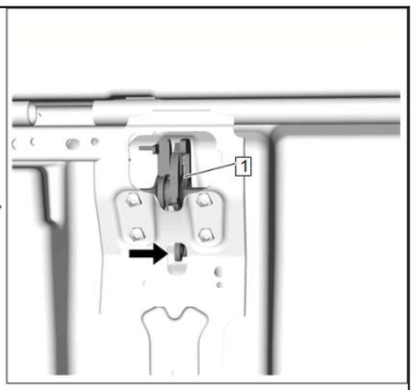

clarification on how to release the upper rear seat on a 6th-gen ZL1 1LE
The ZL1 1LE does not have the strap, but the latch is the same. Here's the trick, you need to unlatch the seatback from the trunk:
Since I had trouble with this recently on my 2019 ZL1 1LE, to release the upper seat back, you have to push IN (forward towards the front of the car) on the steel tab indicated by the arrow in the picture, not pull back on it (toward the rear of the car):
Originally Posted by Stephen12ZL1 View Post
1. Remove lower seat cushion: 2 clips hold the lower panel in place, near the
front lip of the cushion. Use a screwdriver or similar tool to push in to release each side. You can also lift the rear edge of cushion first, and the clips will come out this way as well. Pull lower seat cushion out of car.
From the Shrader Performance page
Lifting the rear edge of the lower seat cushion (after releasing the upper seat cushion from inside the trunk, obviously) worked for me to release the clips under the front edge. No tools or prybars required; just used my hands.
