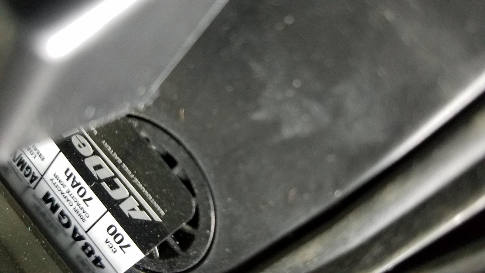

The Camaro used a lead acid battery. That I know of GM doesn't use a AGM in any vehicle they sell currently.

The v6 batt is AGM, clearly marked that way. Will post pic of my batt next week.
Wow, I am going to be really surprised then. more so since AGM batteries are not cheap.
https://www.amazon.com/gp/product/B0...?ie=UTF8&psc=1

Originally Posted by JCunningham View Post
is the battery we have in our cars AGM or lead acid. The charger that comes with are cars says for lead acid batteries on the front page.
From page 279 of the manual:
The vehicle has an Absorbed Glas
Mat (AGM) 12-volt battery.
Installation of a standard 12-volt
battery will result in reduced 12-vol
battery life. When using a 12-volt
battery charger on the 12-volt AGM
battery, some chargers have an
AGM battery setting on the charger
If available, use the AGM setting o
the charger, to limit charge voltage
to 14.8 volts.

the v8 has lead acid v6 has AGM
Where does is say that? I hate owner's manuals that try to be one size fits all when there are so many differences.

no not posted above. I found it in another thread. but that was wrong. I just went out and my SS has a type 48 AGM in it. If you look up the charger that comes wit hut cars it says Lead Acid only on the front cover
