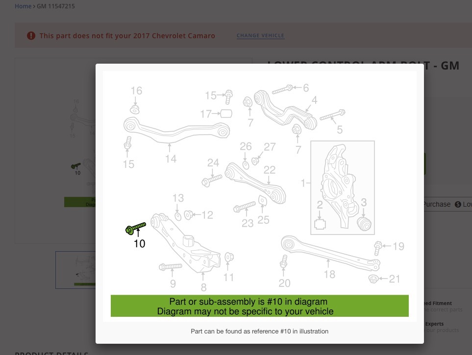

I have a 2017 ZL1. When I look up the part number for the rear camber bolt (11547215), I get a warning that it does not fit my car. Can anyone tell me if there's a different part number for the ZL1?
Found?
