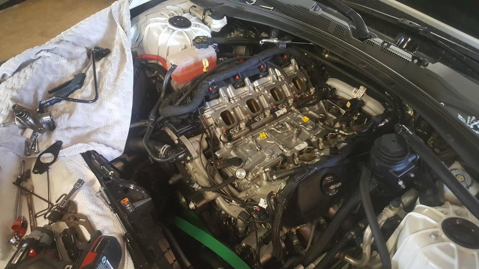

Attempt #3
Tuning will go down Tuesday. Popped the lt4 pump back in, and added the larger low side fuel pump.

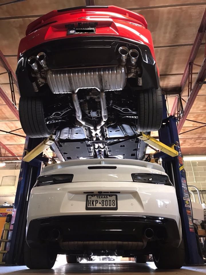

A10 ZL1 is getting some H/C loving
