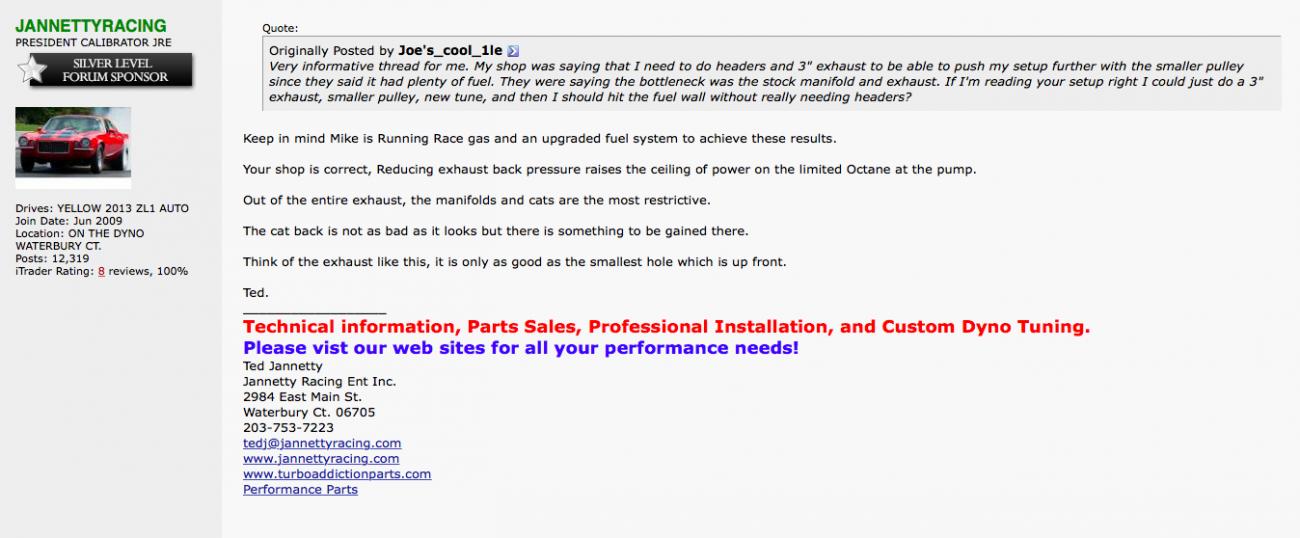

Actually back pressure with these stock manifolds is exactly where my issue is. Fuel has not been a problem for me but back pressure has. Headers are a must for my FI setup.

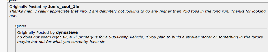

2" headers are for high power applications. You would actually see a drop in boost unless you were hitting close to 1000HP. That's straight from multiple sources/vendors on this forum. Recently discussed in the below link.
http://www.camaro6.com/forums/showthread.php?t=487611
2017 1LE SS Black - Mods - Forged - lowered compression - BTR custom Cam - Whipple, 3.500 upper and 8.0 lower pulley, Roto-Fab, 1 7/8 Kooks headers, off road pipes, & 3" Kooks full exhaust. LT4 fuel system, with Alky single nozzle running 100% meth. (not installed yet) DSX Tuning flex fuel and DSX tuning Aux pump

And this was to me from dynosteve.
