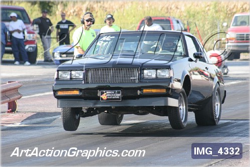

NOS and large turbos are very fun! On my grand national I ran a 88mm and very tight converter but would spray 75hp shot and turn it off at about 110kpa. You get the best of both worlds by running a tight converter.
