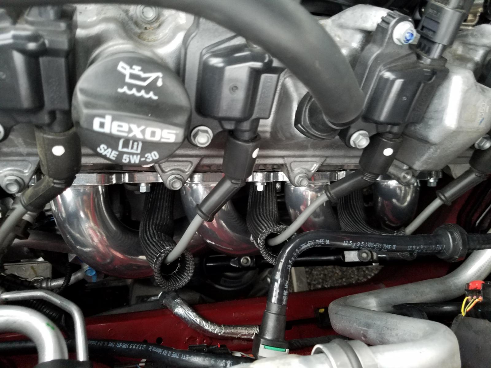

I bought some MSD wires that would allow me to bend the boots.

In the first pic you can see the interference with the factory spark plug wires.
Second pic is with the MSD wires and Problem solved.
