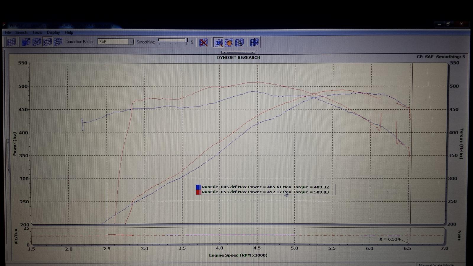

Two identically modded cars except the MSD vs. my ported stuff.

The normal loss of tq is 25rwtq ish. On the cam car is was almost 50rwtq down low. I will get that graph. It was really bad on the cam car.
You are in it to win it now brother. I would just have your MSD ported at this point. The MSD needs the TB ported as well for velocity and overall air flow capability.
