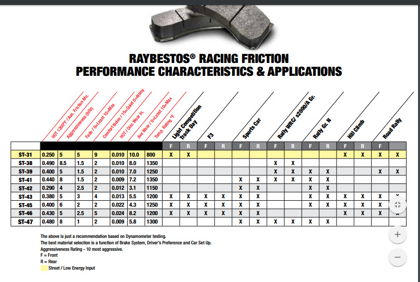

I did follow the bedding procedures and I am pretty sure my friends did as well
Have you ever tried Raybestos pads (ST43 or ST45) or better yet, had a chance to compare with them ?
If not, it's well worth to give it a shot, IMO.
Carbotech pads simply cannot keep up with the Raybestos pads when it comes to stopping power, resistance to brake fade, longevity and ability to use on the street due to operating temps
Not so many makers (if any) post the actual friction values and operating temps
Here's a link for more detail
http://www.raybestosbrakes.com/magno...cing-pads.html

It's good to find something you like, but your enthusiasm is getting the best of you. Especially with comments like the bolded one, which are marketing hyperbole at best. There's no reason to diss one of the best pad brands out there to simply say you like what you run.
Of the Raybestos pads, my favorite is the ST-43, and overall I found it "tolerable" despite its hunger for disc wear. That said, I haven't run it in over a decade, the marketplace and the benchmark has moved onward. Now there are many better pads out there. There are so many Carbotech (now G-Loc) fans because they're actually that good.

Something else to consider is literally all the track reviews do not complain about the brake pads, barring an off-hand comment by Randy Pobst without any further explanation.
The stock pads might actually be quite good. It'll be interesting to see how they benchmark against known good track pads like the Hawk DTC-70, G-Loc R18, Cobalt XR1, Wilwood A, and so forth.
For those that are only doing a couple HPDE's a year, the stock SS 1LE pads might actually be acceptable. I'd at least try them out before buying something else.

but how? .. I am not dissing but just sharing my own experience in the bolded sentence, FYI I am not affiliated with any of the two, lol. Stating a simple fact is not dissing the other brand and there is no polite way to say one is doing a better job than the other..especially when/if others have similar results. I never said Carbotechs are POS or not worth the money..
I had a chance to compare Carbotechs (XP12s) with ST43 (same car, same tire, same track with similar conditions) and immediately noticed that ST43s do a better job (as it did with my previous cars) except maybe the noise level (not a whole a lot but Carbotechs were less noisy I think). Please do share those "better" pads and how you define "better"?

I would never run those corrosive DTC 60 or DTC 70 on my cars but that's just me of course
I think you meant 'abrasive' not 'corrosive'. Stopping power is a measure of how abrasive a pad is. It's the nature of the beast.
If you'll note, the pad you mention, the ST-43, has a 'hot (1200F) MU of .38. The DTC-70 is .85.
That's the only quantifiable number in that document you posted. The rest is totally subjective 'ad-speak'.
BTW - pretty much everyone posts the info you tout as only coming from Raybestos.
http://www.tirerack.com/images/pdf/p...und-Charts.pdf
Driving styles are different. I have personally used Hawk and Carbotech and think they are both great products.
I am just trying to pass on info on what fits these cars when people begin to track them.
