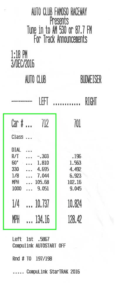

So... first pass is below. I left at idle and rolled the throttle to the floor in the period of about 1 second. Car rolled out nice and ran a touch faster ET than my previous best, but with 5 more MPH than ever before at the big end.
Name:  Camaro Dec 2016 Redlist.jpg
This looked promising, tires seemed to hook great and car want straight as an arrow. Small tires (with that short rollout) caught me off guard and I relit, but I can fix that. My 60' on this pass was only a 1.81 and I normally run mid 1.5's so that's worth at least .3-.5 ET right off the bat. I also know I have some torque management still in the launch, if I remove some of that and load the car up on the converter at launch - maybe another .1 to .3 there??? Either way it's a low 10 -or- could it be possible to squeeze into the single digits? Either way I was excited, love going fast so lets do it! Well here's what happened:

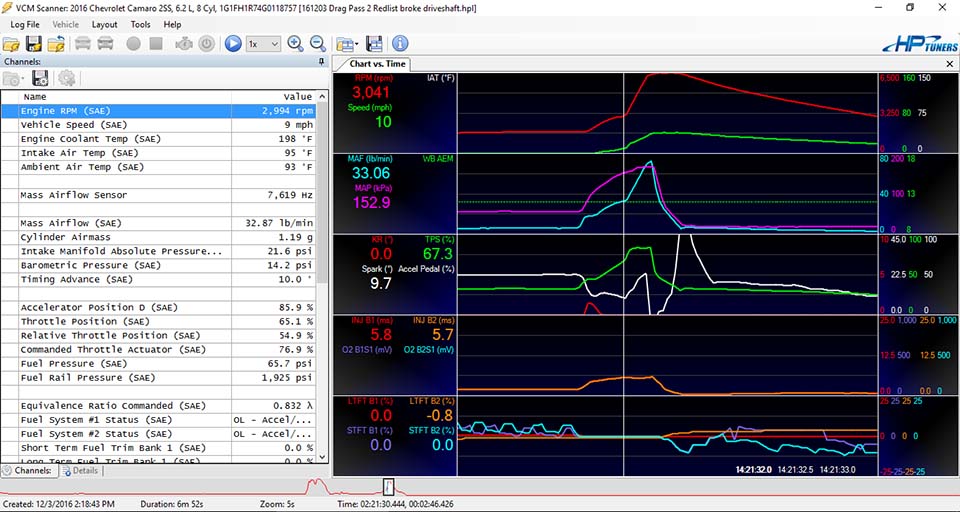

I had it up to about 1750RPM at the tree, released the brake and dropped it to the rug, tires hooked big time and made it all the way to 9mph before "BAM". I don't think there was a person in the stands that didn't hear that one... You can see from that data that it let go right at about 3000 RPM and 153 kPa of manifold pressure. I haven't yet removed enough TM to make the throttle immediately open full so there might be more torque available in the launch if needed.
I do know it's the driveshaft but until it's up on a lift I won't know exactly what happened. Either way I'm looking to get it back up and running as soon as possible to get back to the track and see what it will run.

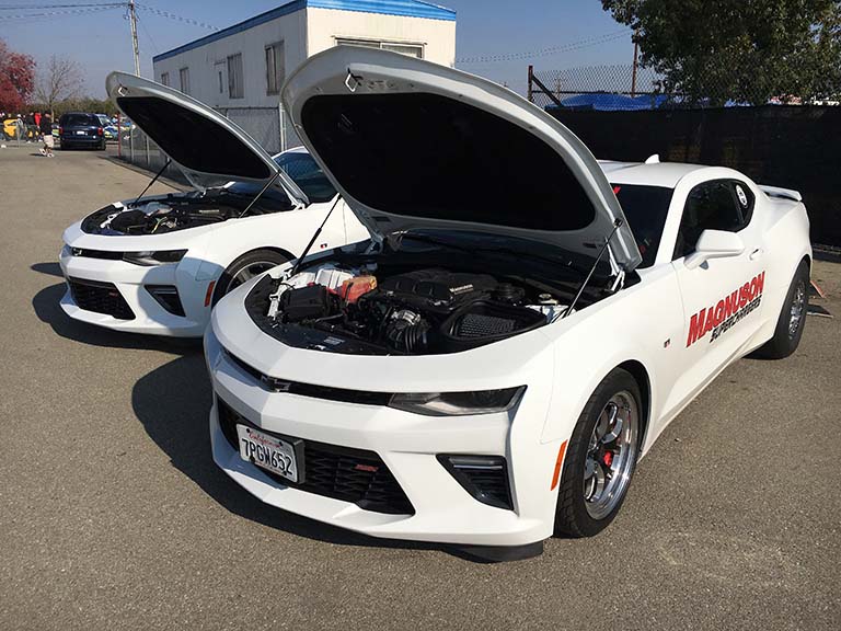

There was also had a "twin" white 6th gen A8 (see image below) sporting a Maggie and a couple other mods built by Alex at New Era Performance that ran a 10.44 @ 132MPH on his first pass.

Originally Posted by crash0117 View Post
Was it a Driveshaft shop cf driveshaft?
It was, got it up on the lift today and it failed the carbon fiber tube about 6'' from the transmission. I had originally though that maybe it would be a glue joint, but that was not the case. Not sure if we'll go with a replacement or maybe switch to aluminum.

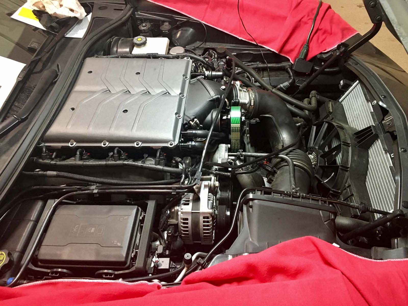

Driveshaft arrived yesterday, hopefully have the Camaro running again soon but have been focused on my Z06 - it should be running tomorrow...
Name:  Z06 Maggie.jpg
