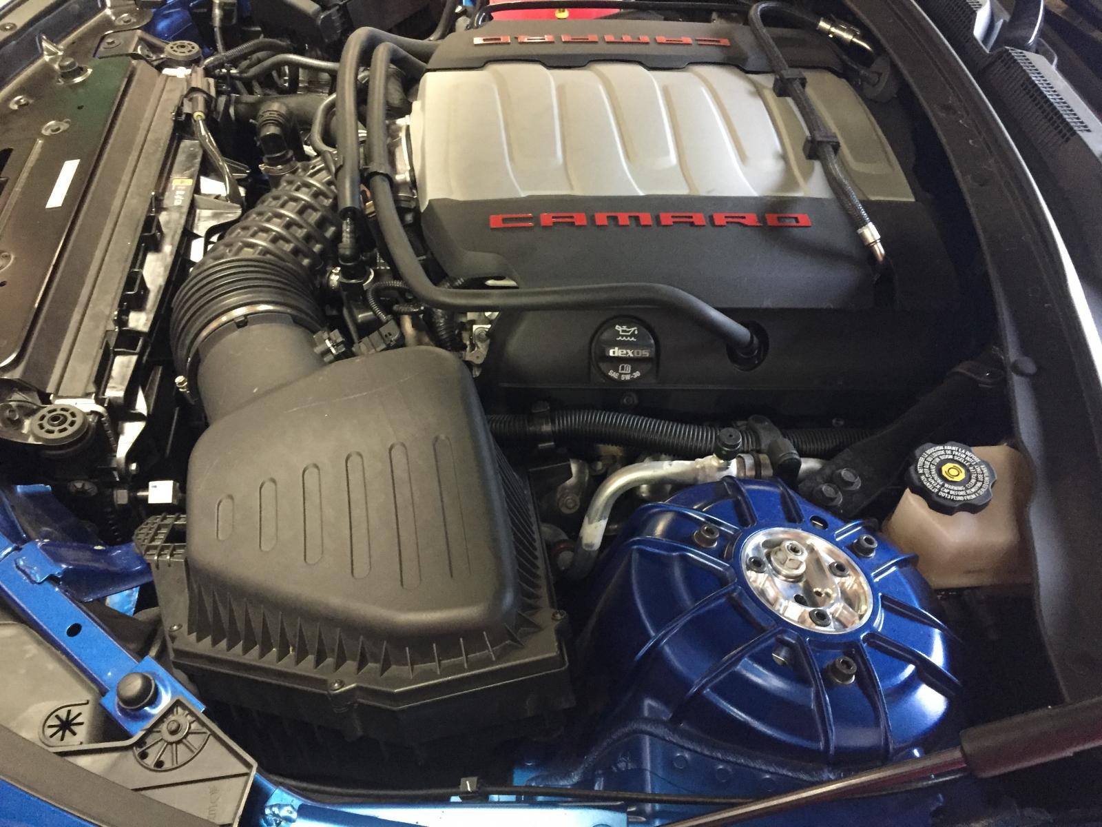

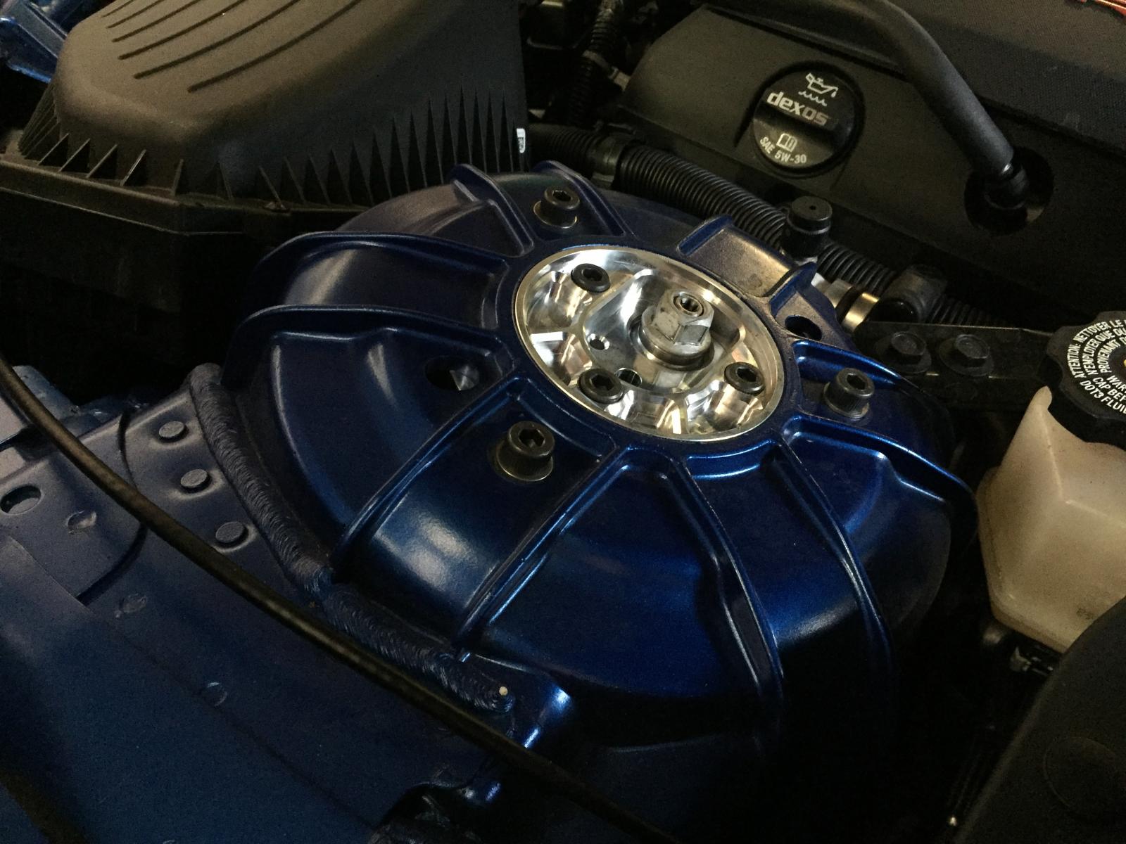

Gen 6 camber plates
Hey guys we just finish testing our new camber plates. Will be going into production in the next week. stay tuned for more details.
