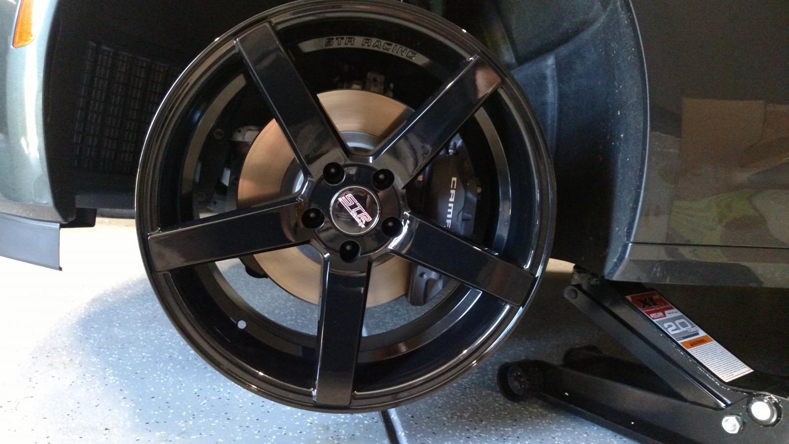

I can't wait to see this thing finished...this is going to make some serious power. You could be looking at over 700rwhp. Are you staying with the stock wheels, tires and rear suspension components?
Already installed BMR springs and have STR Racing wheels with Not to NT-05's mounted and ready to put on.

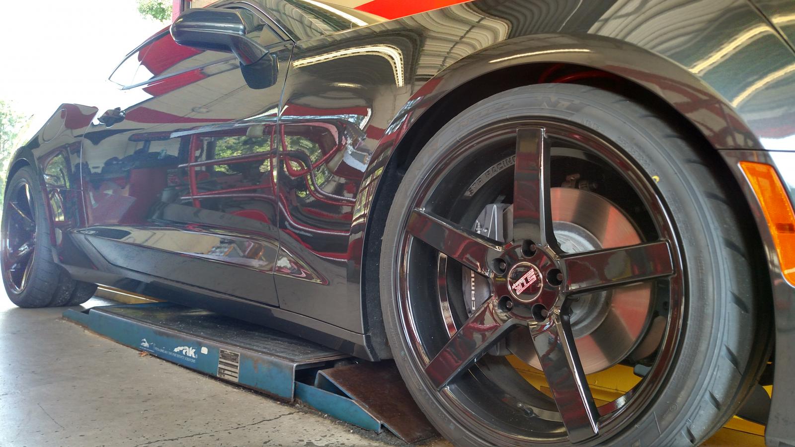

Wheels are on and I'm doing the engine break in miles now. Dropping it off Wednesday to do the dyno tuning and
pulley swapping along with a few other things that need to be installed.

First Dyno is in. Made 699hp and 711tq @ 10 lbs of boost. Completely stock fuel system with meth.
Next up CPR low side fuel system, 10.55 lower pulley, 75mm upper pulley, 103mm throttle body, and Roto Fab intake.
