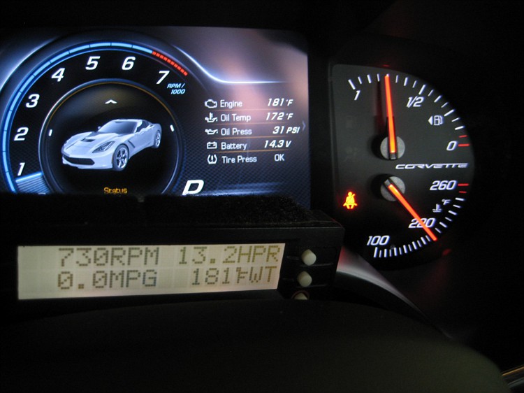

Speaking of Dummy gauges, here's a comparison from my C7.
Scan Gauge, Digital dash (181 Match), and Gauge (220 No match!)
Analog dummy does not represent real temps..
This was done while bringing the car up to temp, and shooting the Pic when the Gauge hit 220 which was it's normal running position but NOT a real temp as you can see..

Usually the values returned through the OBD2 port and similarly to the ECU are real numbers. These appear to be the same. I expect it's this value used in determining tune parameters, timing advance etc. A dummy analog gauge is just along for the (averaged) ride...
