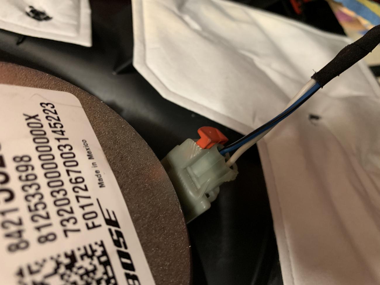

I have a dumb question I need some help with on this tip. Can anyone (Chris227?) tell me exactly how to disconnect the wiring harness clip from the circular rear speaker shown in the attached pic? It has a red tab I slid backwards with a small flat blade screw driver, but I don’t see if anything else needs to be unlocked/pressed/etc or if I just need to pull harder. I’ve pulled pretty hard already so am hesitant to pull harder unless I know that’s the way.
TIA!
TIA!
Can't see it from the pic, but these locking clips typically have an extra hook or tab behind the middle cutout of the red locking tab that needs to be pressed inwards to disconnect the plug.
TIA!
It's been awhile since i removed mine.
If i remember correctly the small tab is located right under where the locking tab slides down in your pic. Just press in and pull.
I believe i used a small Flathead screwdriver and pressed it in on the tab and pulled at the same time.
