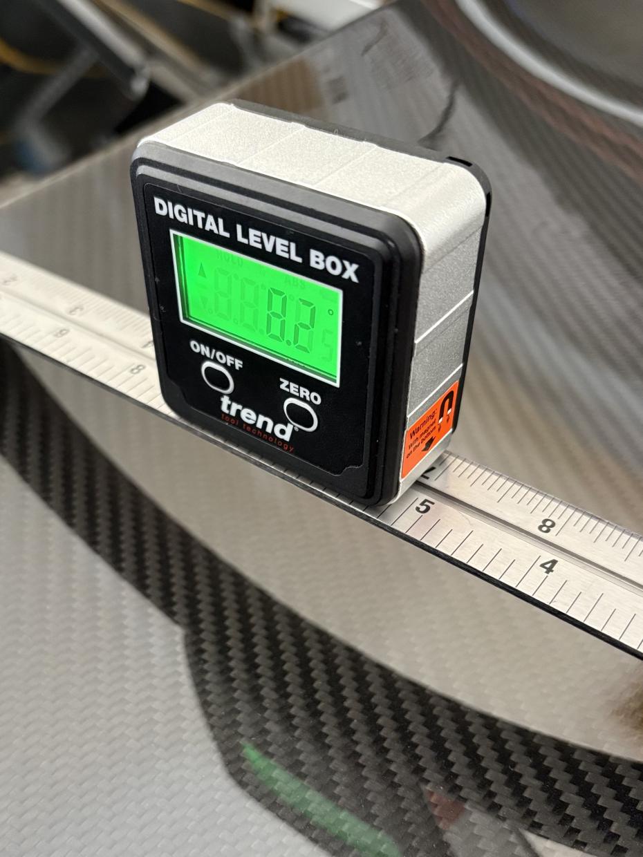

After sending a few emails, asking around, and even using AI, these are the results that should keep the car from squirming and net me faster times.
APR wing adjusted from ~10 degrees AoA to ~8 degrees AoA to provide less drag and optimize downforce at 30-100mph.

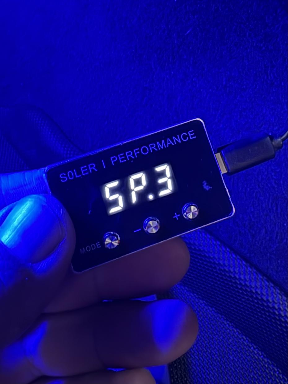

Soler throttle controller dialed back from SP6 to SP3 to better maintain throttle control.

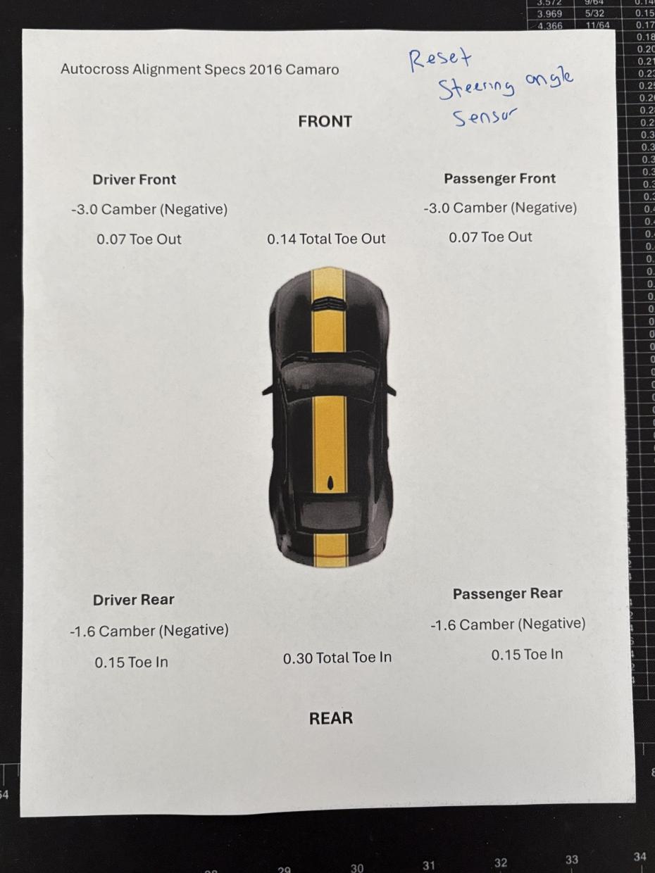

New alignment specs with toe out in the front, -3 camber, and the rear camber slightly less from -2.0 to -1.6, with a good amount of toe in to keep the back end grounded and utilizing the full contact patch of the 295 tire.
Lastly, run with hot tire pressures of 30psi front and 27psi rear.
