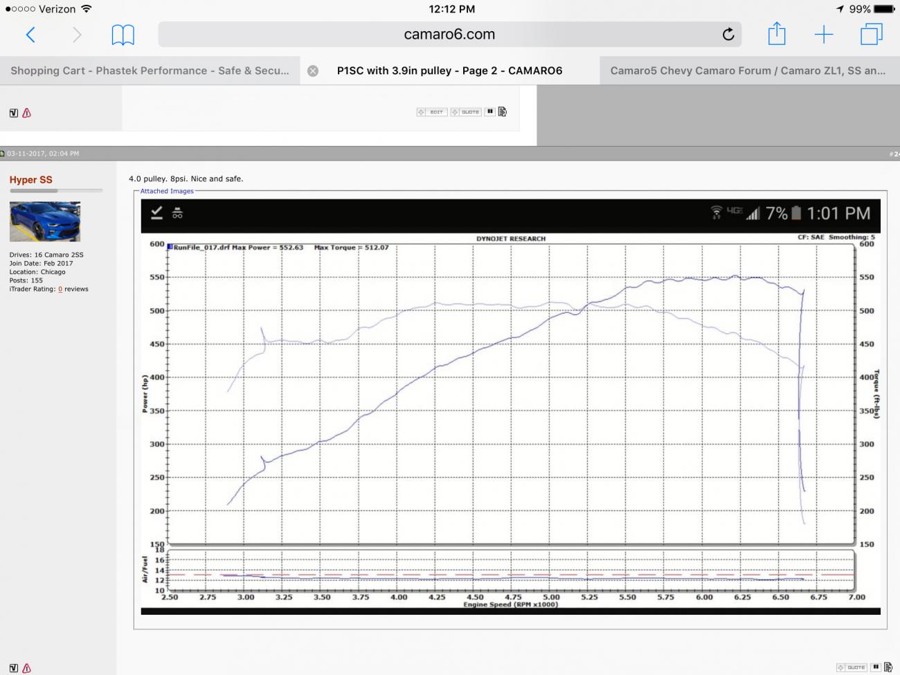

12.65 is almost a N/A tune. We would shoot for 13-13.3 when I had my dyno. F/I cars were 10.0-11.0 max AFR. So Ted has a very valid point. 12.65 is way to lean for F/I car.
I disagree strongly, I've never had an F/I car in the 11's. I lost nothing on the high pressure side and only 2psi on the low side.
When it was your car, you thought 12-13 afr was nice and safe. You never got below 12, now you're trying to tell me mine is way too lean?? My car never gets close to 13.

I'm pretty sure that's when my low side was not keeping up. Before the fuel pumps and injectors
It was when your fuel was nice and safe running the 4.0. Which I agree, it was in the safe zone. 10-11 is too rich and taking horsepower away from you. I would bet money you're in the low 12's now just like I am. Which is the sweet spot. I ran my cts-v in the low 12's for over 32k miles with no issues from the engine what so ever. I was hard on it too.
