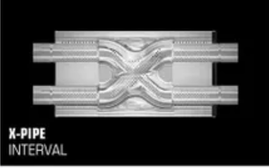

Doesn’t look like that calculation is correct for this muffler looking at the internal muffler pics…
I seem to recall there some discussion on this muffler last year and if I recall, early versions of this muffler (or maybe the PN was slightly different) did actually combine into a single 3" section but later versions were proven to be an actual X pipe internally and not a single 3" section. Maybe that's where some of the confusion is coming from. I eyeballed mine very well before installing it and mine was a true X internally, there was no single 3" pipe section.

I seem to recall there some discussion on this muffler last year and if I recall, early versios of this muffler did actually combine into a single 3" section but later versions were proven to be an actual X pipe internally and not a single 3" section. Maybe that's where some of the confusion is coming from. I eyeballed mine very well before I stalling it and mine was a true X internally, there was no single 3" pipe section.
That would definitely make a big difference if that’s the case and might explain why airtroop had issues but I didn’t.
12469 was the original part number and the muffler everyone was using. I’m
Not sure what 12599 is, maybe they replaced the design with a true x design or it’s a new part itself.
However 12469 still exists for sale from numerous places.
Actually I just double checked. 12599 is a completely different part #/muffler.

I have the 12469 muffler and its a true X internally. I'm thinking there were earlier versions that may not have been a true X muffler and had a single 3" section but later revisions were true X internally. I wouldn't have installed it on mine if it was a single 3" pipe internally, I visually looked through mine and it was a true X internally. Its possible if they have the same PN that some retailers might still have the older version in their warehouse and some might still be receiving those when ordering. I'm half tempted to order one from Amazon just to take some internal pics and then return it to put this issue to bed.
I bought mine like what 9 months ago and it’s a Y design. The diagram on magnaflows website still shows it being a Y design.
12599 however is a true X pipe.
This is all I can find about 12469 on Magnaflow’s website. While their little video clip portrays an X design, they don’t give a look at the mufflers internals. Also, I apologize for screwing everyone up with the 12599 pics, as I indeed have the 12469 as well.
Part number 12469 - I had talked to the engineers at Magnaflow and requested the internal schematic of the muffler. They confirmed that although the website shows an X is is indeed a Y
If you look at the attached schematic, lower right corner is #12469
They mentioned they have other mufflers that indeed have an internal X
But this form that fits in the tunnel with a 5x8” and variable length doesn’t exist with them with an X. They are typically wider.
Again passing what info I got from the tech.
I really wanted it to work out for me but it is what it is.
As an aside, I installed the 3” in out MBRP resonators and while the sound is louder/more aggressive… I was able to go full WOT, full power and breathed a sigh of relief. Still need to figure out a quieter solution for certain tracks but if I am cruising around and don’t jump on the throttle it’s quiet enough and quite reasonable.
