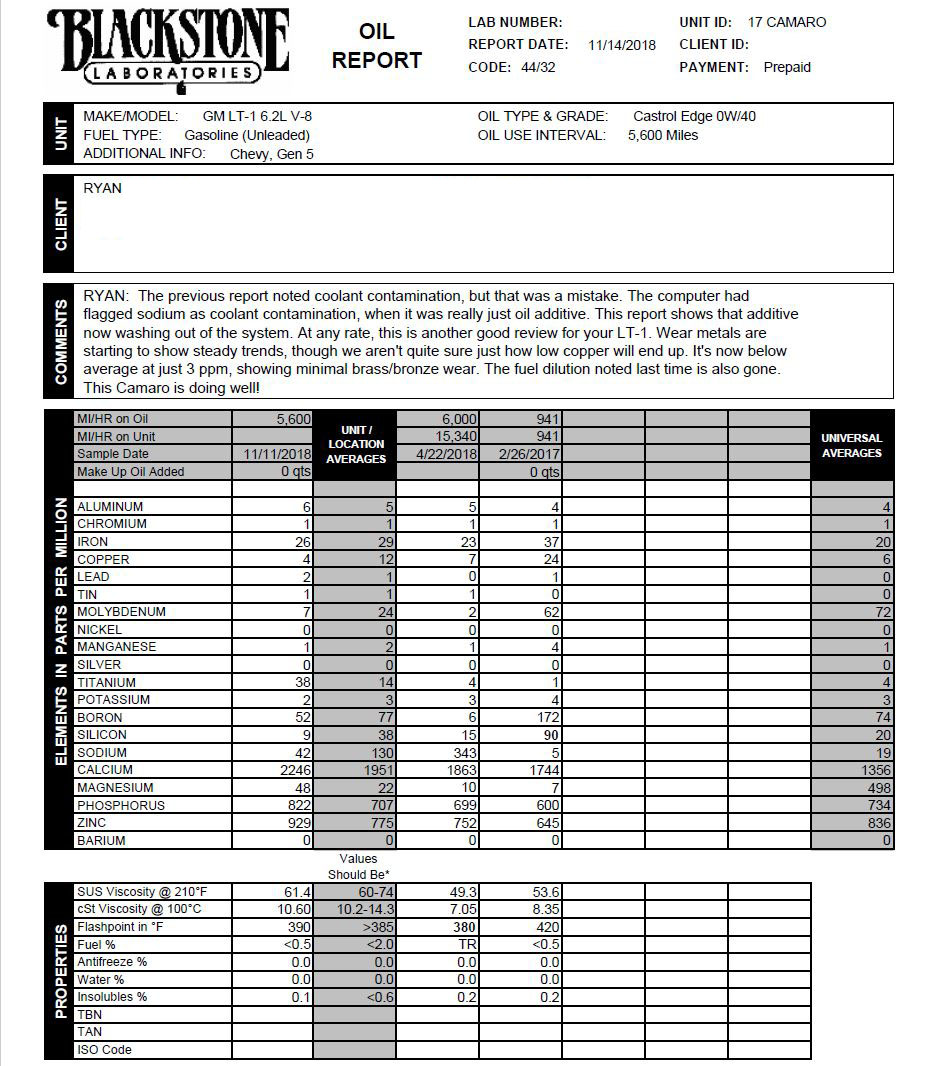

Here is my latest Blackstone UOA sheet.
*941 miles is the factory fill
*6k interval at 15k miles is actually the 3rd fill, used over winter '17/'18. It's Valvoline SynPower 0W-20 Dexos1 Gen2. This lower viscosity is for winter/street-only driving.
*5,600 interval is the most recent, at 21k odometer. It's Castrol Edge 0W-40 A3/B4, a high SAPS package. Perfect for track days.
The wear metals are stable, so it's fair to say the engine is broken-in. I'm disappointed in the Valvoline sodium-based additive package and low flashpoint. The Castrol is on-point with it's higher additive package. I am also impressed with the factory fill flashpoint.
The car currently has Pennzoil Platinum 5W-30 Dexos1 Gen2 in it for this winter, and then I'll likely go back to the Castrol 0W-40 A3/B4 in spring for next track season.

Great thread! I’ve learned a lot, and now on the lookout for ZL1 1LE calipers. Unless I found the wrong stuff, that Castrol oil is only $50 for 10 qts.
https://www.amazon.com/Castrol-03101.../dp/B00JGQLZSU
Is that right? Do you have a filter preference? I’ve seen good stuff on the Mobil1 and Royal Purple filter based on tear down videos on YouTube.

Glad it's helpful!
Yes that's the oil I use in the warmer half of the year. For oil filters I use the ACDelco PF64. It's a good quality filter and super inexpensive.
