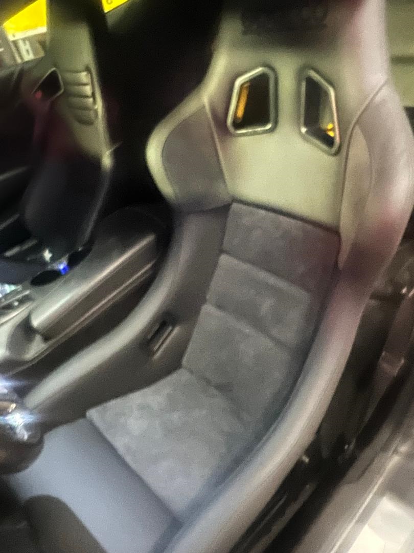

Sparco Seat Installed today
OK well I installed SPARCO QRT seat last night using planted technology seat brackets and side mount brackets, PICS are below. The SEAT weighed only 20 pounds by itself. The CARBON fiber version weighs only 10 pounds. When I ordered this seat I DID NOT get the seat mounting hardware kit mainly because I THOUGHT that a set of side mounting seat brackets would come with mounting bolts , RIGHT??? Well, they DO NOT. Get the hardware mounting kit It will save you a trip to the hardware store (LOL). I already had FOUR Class 8 bolts with NYLOCK nuts that I had previously used to mount the original POS track seat I had so I was good to go there.
https://competitionmotorsport.com/co...43205359993051
The planted technology seat bracket and side mount brackets weigh 15 pounds together (SEE PIC). The last pic is of seat installed in car. A STOCK SS 2S seat weighs roughly 55 pounds. Basically then the sparco seat is 20 pounds LIGHTER than stock seat.
I am going to make a minor adjustment in that I will move the seat about a inch or so CLOSER to the door side to allow a little better access to the seat buckle. Right now it is a bit of a pain in the ass to get to.
Install tip, you need to install the seat brackets BEFORE you install the seat. The reason for this is that the planted technology bracket has to be installed in the slots in the floor and that initially is done at about a 45 degree angle and the pushed forward to lock down in place PRIOR to attaching the BACK of the bracket to the floor with the T50 TORX bolts.. If the SEAT is already installed on the brackets the you CANT get the 45 degree angle you need to STAB in the FRONT of the bracket into the floor. When I attached the SPARCO seat to the planted technology seat brackets I had to drill ONE hole for one of the four Class 8 bolts that I used to attach the seat to the planted technology bracket. THREE of the holes in side mount brackets that you attach to the sides of the seat lined up with some exiting holes already provided in the planted technology bracket.
You can adjust the angle of the seat by using the different holes in the side mount brackets. Look at the pic below of the side mount bracket as I currently have it installed. Since I would like for the back of the seat to be a little more UPRIGHT I will move the bolt to the BOTTOM hole on the bracket on the RIGHT side of the bracket which of course will move the BACK of the seat up.
Also I have ordered a buckle extender like this:
https://www.cesdeals.com/products/2p...hoCMl8QAvD_BwE
Because this seat has taller sides than a stock seat, the buckle position located on the console side of the seat is a bit too LOW to get really good access to it. The extender ABOVE will eliminate that issue. One of the pics below show the CURRENT position of the seat buckle which is currently is in a little bit of a hide-n-seek position.
Note that you have to compromise a bit if you DO NOT use seat sliders because NORMALLY your seat will be somewhat closer to the steering wheel in a TRACK racing situation VS. a normal driving position for daily driving. A good track position for instance dictates that your wrists be at or beyond top of the steering wheel when you extend your arms straight forward. Also if you get the seat TOO close to the steering wheel then you restrict your entry into the car. The BACK of the seat normally is a little more upright in a track racing situation as well. All that being said, entry access at the position I CURRENTLY have the seat is pretty good. Any closer to the steering wheel and that starts to become an issue in my opinion.

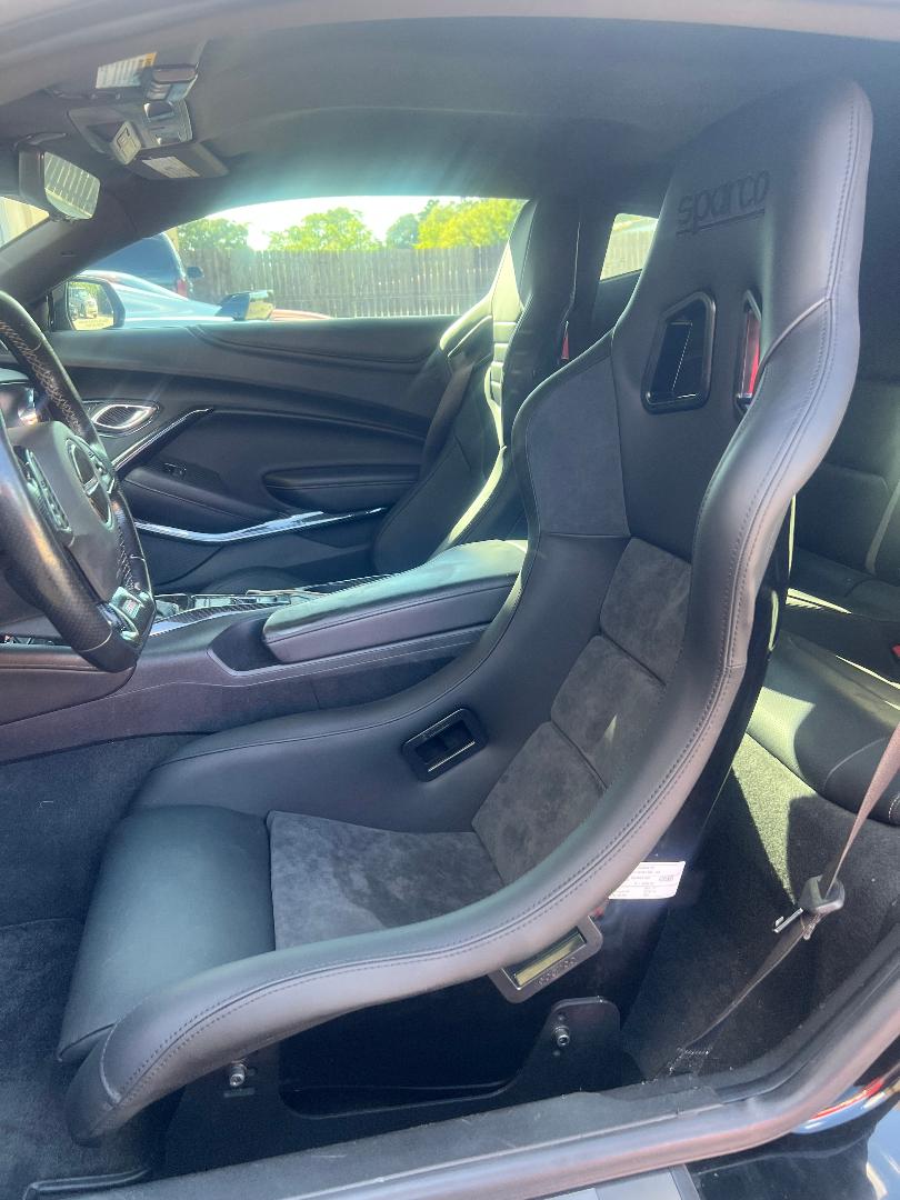

FINAL install position of SPARCO seat
OK guys make a few adjustments. Notice on the pics I have used the NEXT to the bottom slot on the left had side of bracket on the side mount brackets for the attachment position and the MIDDLE position for the bolt for the attachment position for the back bolt.
This made it a little easier on ENTRY and also brought the back of the seat into a little more upright position.
The last picture shows the relative position of the seat to the steering wheel.
My feedback on this seat is it is NOT for anyone that has a waist size larger than 34-35 inches or weighs much more than 200 pounds. MY son is a body builder and weighs 235 with a HUGE back so he looked like a hippopotumus riding a bicycle seat (LOL).
It is SNUG on me at 195 pounds and 5'11" and 35 inch waist but you want that on a track seat. More feedback I will post up AFTER I race with it.
