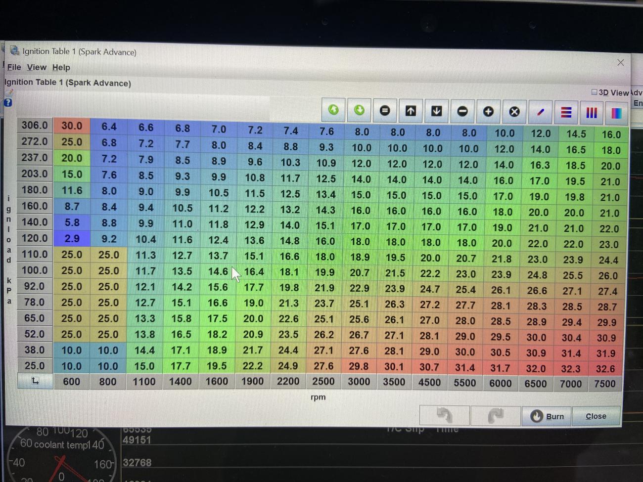

I have been asking around. Some people are telling my that timing drop in the 20psi to 25psi range is probably my issue. I am dropping 2deg there so maybe.
I did play with the timing awhile back but that was before the cam. My next step is dial is back to 10psi and dial in the timing for MBT. Also do the same at 15psi.
With that data decide how much less I want to run and where I want to be at 20psi and 25psi.
In the past with LS motors I would never go over 18deg. The old let the boost make the power thing. It is still possible I have an airflow issue above 1000hp but it might just need more timing.
