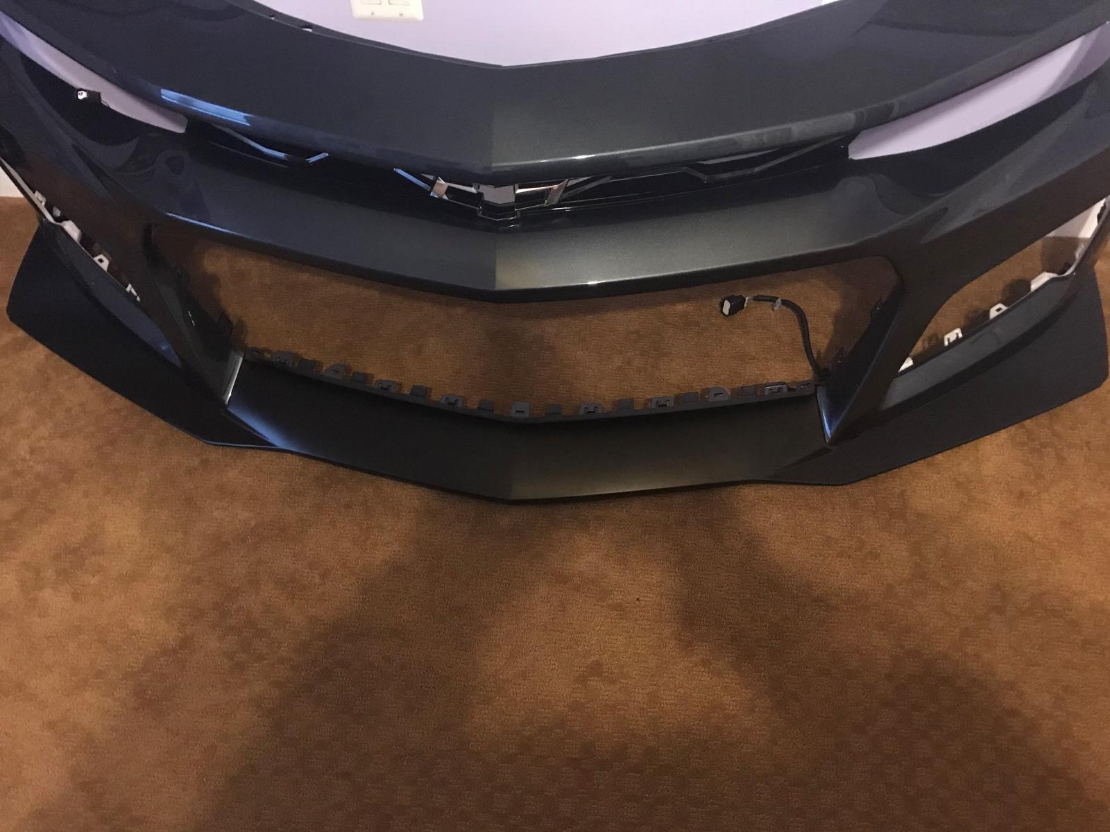

Made my holes in the bumper to receive the splitter deflectors and dive planes. Used a small drill bit and cleaned them up with a x-acto knife. They look a little raggedy, but that is the edges PPF. Also removed the splitter. ZLE splitter arriving tomorrow.

What size drill bit did you use?
I noticed that the current 1LE splitter doesn't have a pin / blade style tab that the last variant had.

3/16 inch.
Got my splitter today. It was slightly twisted. Not sure why, but it is much more flexible that the ZL1 splitter. So I placed it on the bumper, so it would straighten out, or maybe I won't have to take it off at all to get the remainder of the parts on.
Unfortunately the rest of the parts most likely won't be in until late next week or early the following week. The ZLE splitter does have a very slight shine to it. I figure when it gets beat up on the track, I can always take a can or two of Plasti-Dip and make it look new again. Something you can't do with the ZL1 splitter.

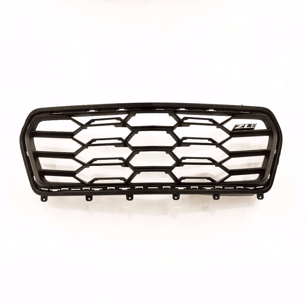

Since lots of folks ask.....and you are at this point....will the 1LE splitter work with the STOCK lower grille? How about if you cut off the tabs on the splitter?
Thanks.....Happy Thanksgiving y'all!
Firecaptain is offline   Reply With Quote
Old 11-27-2019, 05:36 PM   #166
PROMETHEUS
PROMETHEUS's Avatar
Drives: 2019 ZL-1, Shadow Gray, Sold
Join Date: Jan 2019
Location: Fredericksburg, VA
Posts: 1,390
Will not with the tabs on the ZLE splitter. However if you were to remove them, I don't see any reason or obstruction that would prevent that from working. The only concern is, that portion of the splitter is not really attached to anything. I guess you could glue it down to the painted portion of the bumper.
Not sure how you could remove them without marring the splitter. Between the splitter tabs and the bumper tabs, there are 19. I assume the ZLE lower grill has one long tab slot at the bottom, because there is very little space between tabs.

Nope, it has 19 slots at the bottom. That ought to be fun seating all of those!
I found it easier to mount the splitter first then install the lower grill onto the splitter tabs. Actually went on quite easily.
