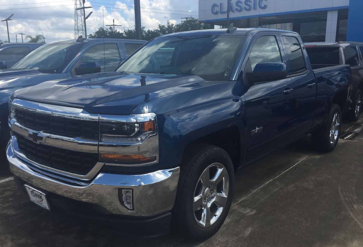

Old 09-17-2016, 09:30 PM   #1595
Posts: 38,033
FINALLY traded in the Trail Boss Colorado today on a Silverado...
Did put 34k on it in one year. This swap was over due though.
