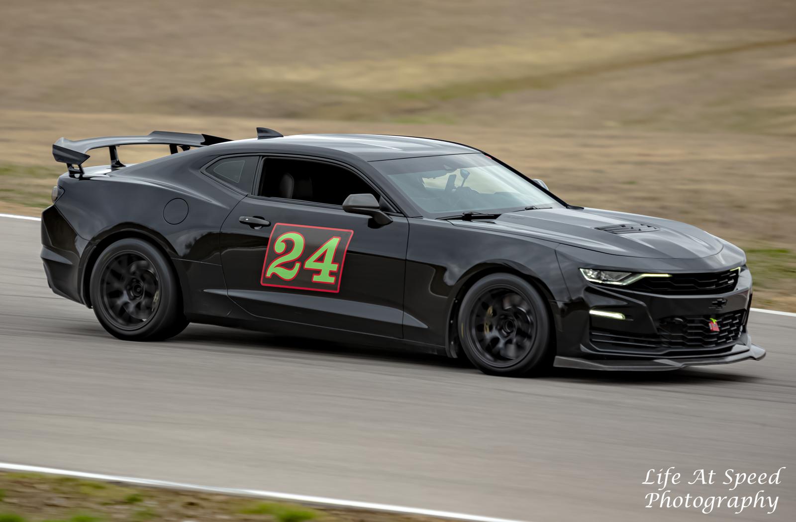

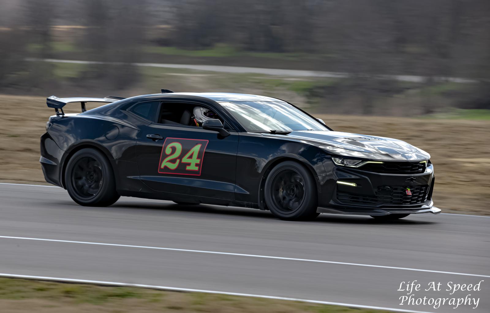

Nice pics thank you, the car looks well balanced through the corners.
THX!! Yeah the handling is basically set up to be NEUTRAL. As early as next weekend we will be making a customized rear diffuser for her that will extend from the rear end assembly to just beyond the rear bumper. The FLATTER the back bottom surface is, the more downforce it should create.
Currently there is an open area between the MAGNAFLOW mufflers where the ORIGINAL Suitcase stock muffler sat. Air flow is disrupted by this cavity and not allowed to exit smoothly out the back of the car.
Of course I could put an ENORMOUS wing on the back to create more downforce but I dont like the aesthetics of that as this is also a daily driver.

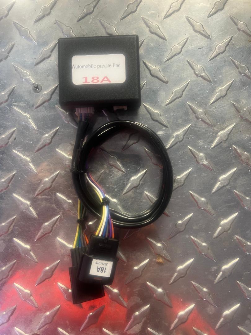

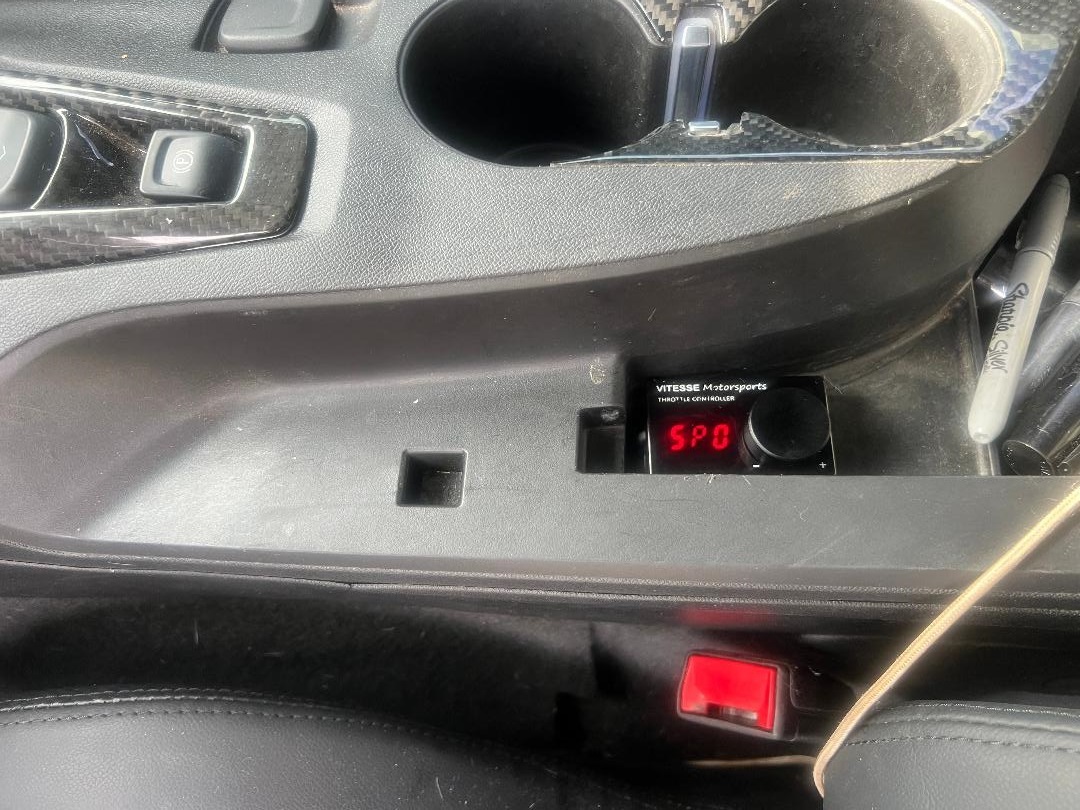

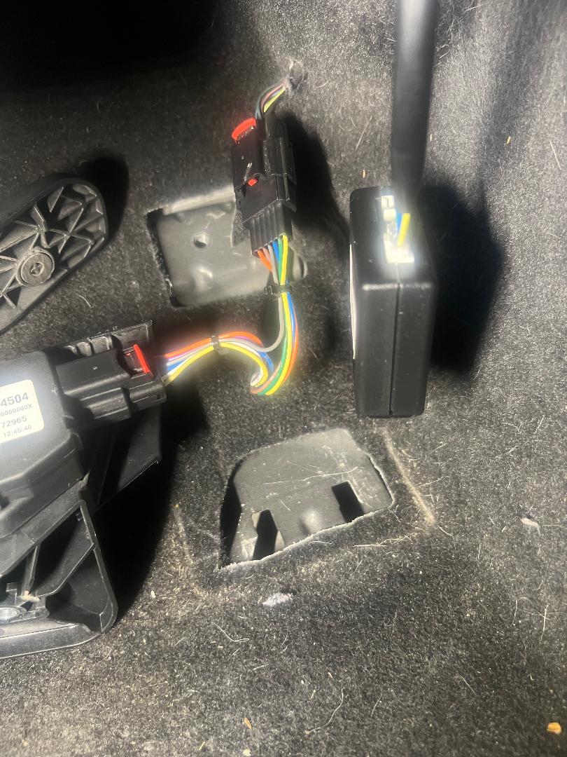

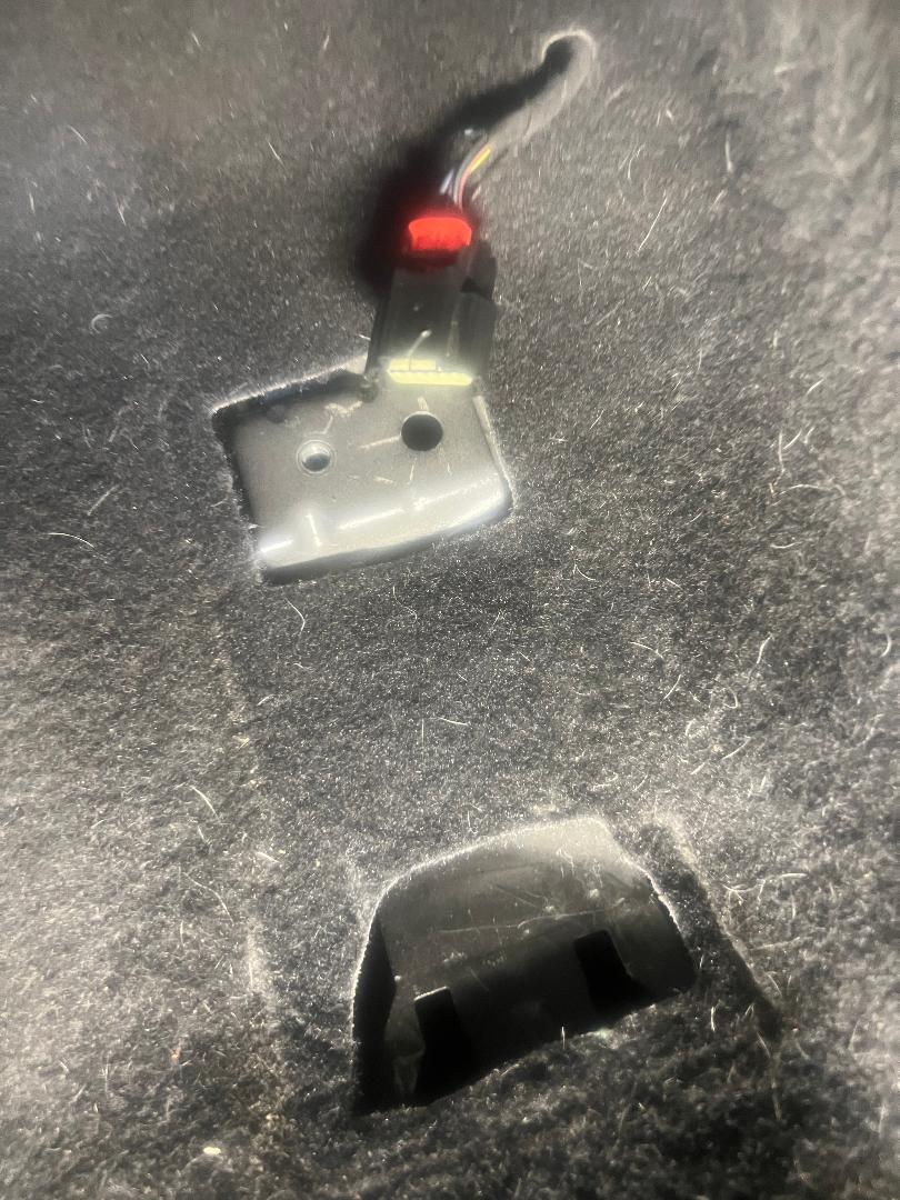

UPDATED INFO on VITESSES controller
Earlier in this thread I mentioned that I would post back AFTER Vitesse sent me a replacement throttle controller box and harnness. I was getting some DTC errors which was diagnosed as being the WRONG model controller for my car.
The PICS below are what they sent me back which consist of the harness that interfaces directly to the gas pedal assembly as shown in the pics as well as the interface box that I attached via VELCRO to the underside of dash.
The DISPLAY unit itself I DID NOT change out and that is still located under the console cover (SEE PIC). The display is currently showing SP0 which means that it will use the throttle settings that are in the ECU table NOW (in my case the AMP modified more aggressive settings).
SP1 to SP9 settings then makes the throttle tables progressively more liner or touchy. SP9 is like an on off switch but SP3 in my particular case felt the BEST. These settings can be adjusted on the fly for whatever track you are running.
So CURRENTLY , I AM NOT getting any DTC errors. My first track day is going to be this WEDS and I will post back after that.
