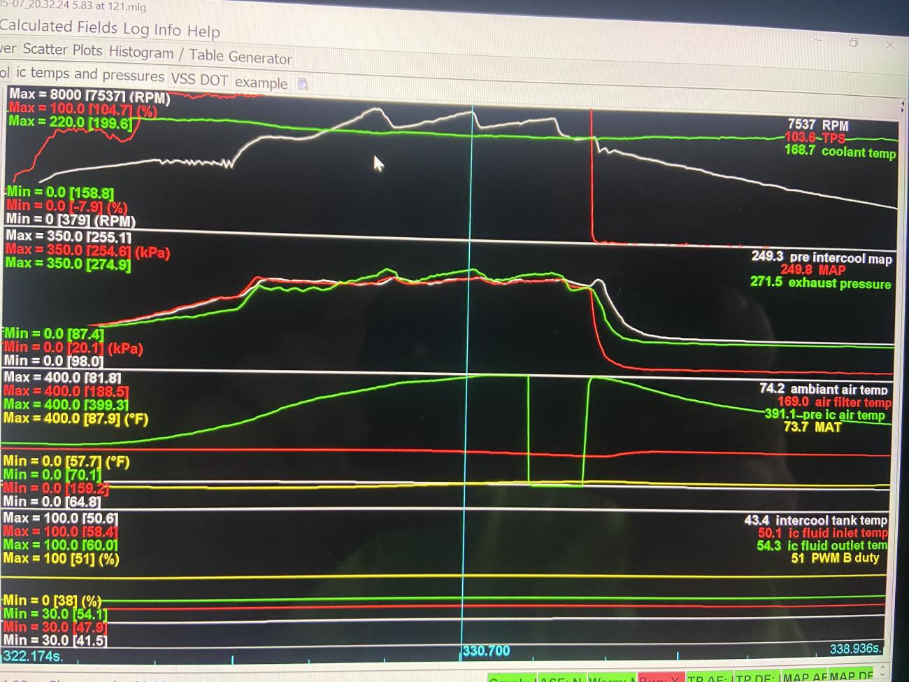

absolutely love it. You're the needle mover once again. This will drop the 6.2 prices and raise the 5.3. Congrats on the consistent 5s. That pass looked so smooth and effortless. You need some in cars and random videos of the whole car. You really have done a lot of misc first time crap with this that i think a lot of people dont know about.
Can you please post the log of the pass, I would like to see the boost by mph ramp in.

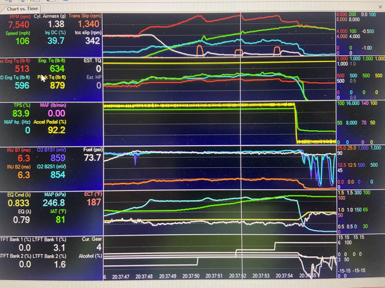

I have a lot of data. I will post up some screen shots. I can email logs if anyone wants to look closer.

I have the afr dialed in a little better since this log. A couple of things I need to work on is running it out in 4th, it is shifting a bit early and I want to try locking the converter at least in the last gear.
After that it is just more boost.

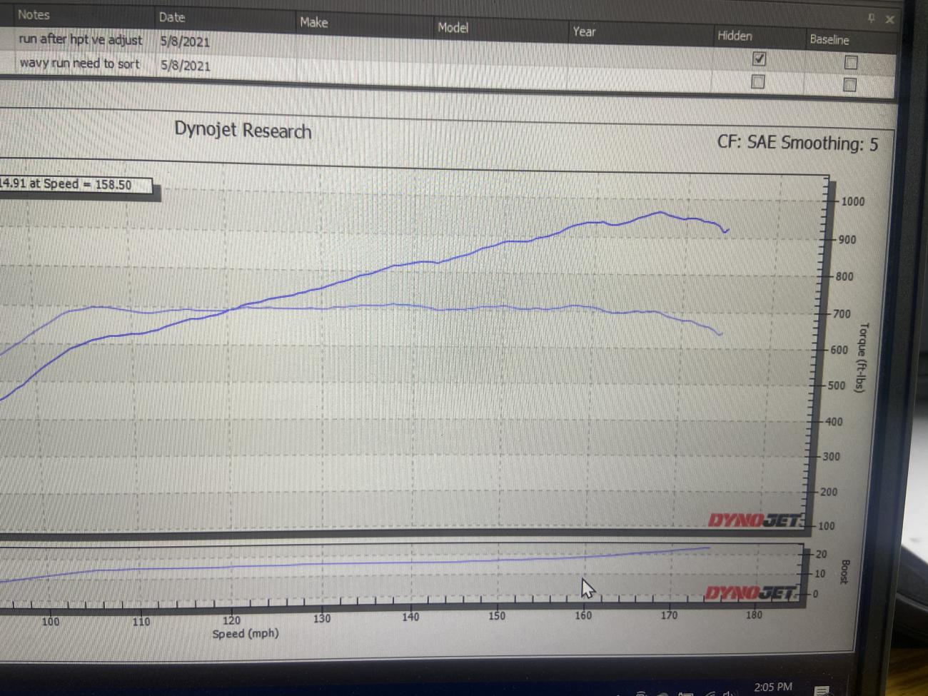

My dyno chart is pretty wavy. I am trying to figure that out. I think I am being too conservative with my timing.

Im a total noob at tuning but...maybe apply some horizontal smoothing/interpolation around 6500...i see more than 5deg jump between cells.

Yeah it could use a little smoothing down low. I am mainly sweating the 150kpa+ timing.

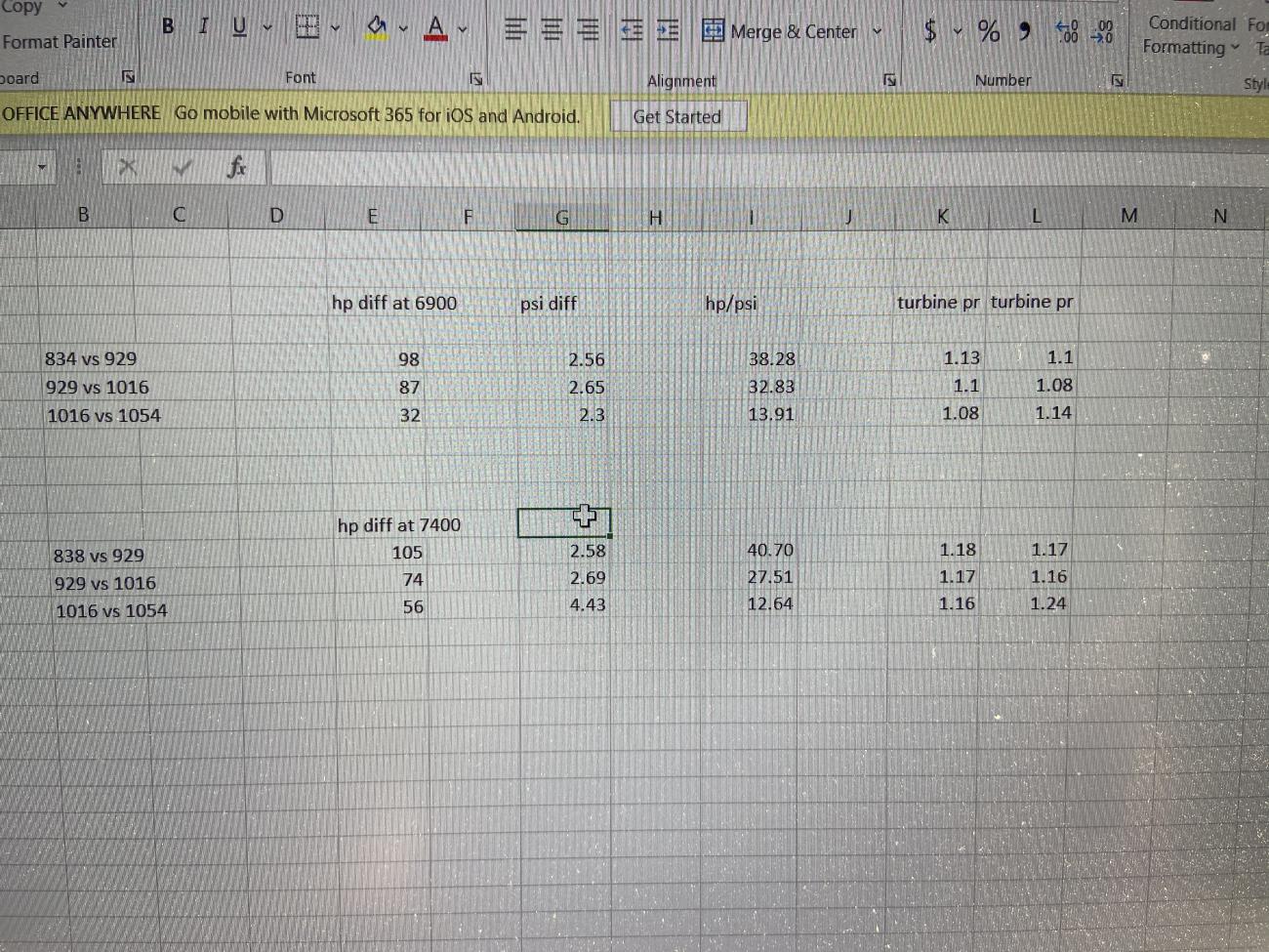

Seems I am approaching a wall. The labels on the left are peek hp but you can’t see what they are referencing. Just know the 1st row compares the lowest hp run to the 2nd lowest, the 2nd row compares the 2nd lowest to the 3rd lowest... then starts over at the higher rpm.
I am thinking turbines or air filters. I am going to pull the air filters next time

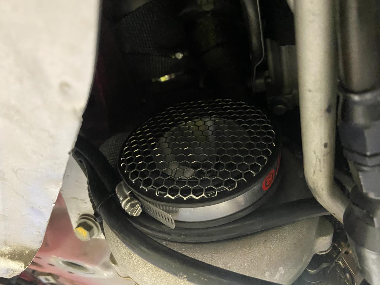

I tried a pair of these over priced turbo guards. I also tried no filter or guard. I had the exact same results. It just isn’t happy over 1000hp. Great gains in the 15-20psi range but above that it tapers off quickly.
Right now I am thinking cam selection or valve train control is holding me back. It could be the compressors are done but they are 67’s and rated at 900+each so that seems unlikely. The small t3 exhaust housings seem like a possible issue but the current pre turbine exhaust pressure is still low I think. I did check my sensor compared to a manual gauge and the readings are correct. Ignition maybe, I narrowed the gap to .017 and bumped the swell.
I have some other stuff going on so I might just have be happy with this power level for now.
