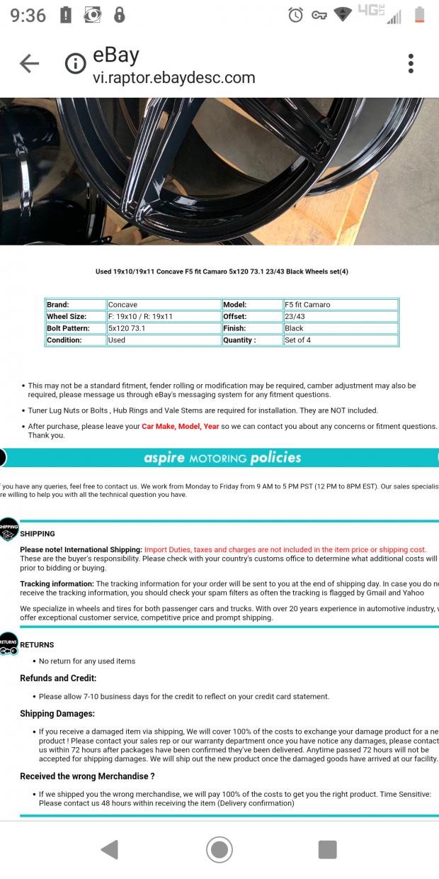

I have my 19 in set up pretty dialed in so thought I'd share.
Using 5mm spacers up front with Silverado extended lug nuts, -2.9 deg camber front, did wire tuck in left rear, (no rubbing on fender liner anyway)
19x10 et23 305/30/19 19x11 et43 325/30/19
Goodyear s3 tires 220 tw so I can run BS AUTOX
(4th raw time, 3rd pax out of 80+ cars at first autox with this set up)
Liking it a lot so far.
Eric
Eric
How is the feel of the car with this setup? I've been thinking about doing something like this for a track setup and wondering how the wider tires on this width feel. Did you lose any steering response or feel? They look a little pinched but not too bad. Thanks.
