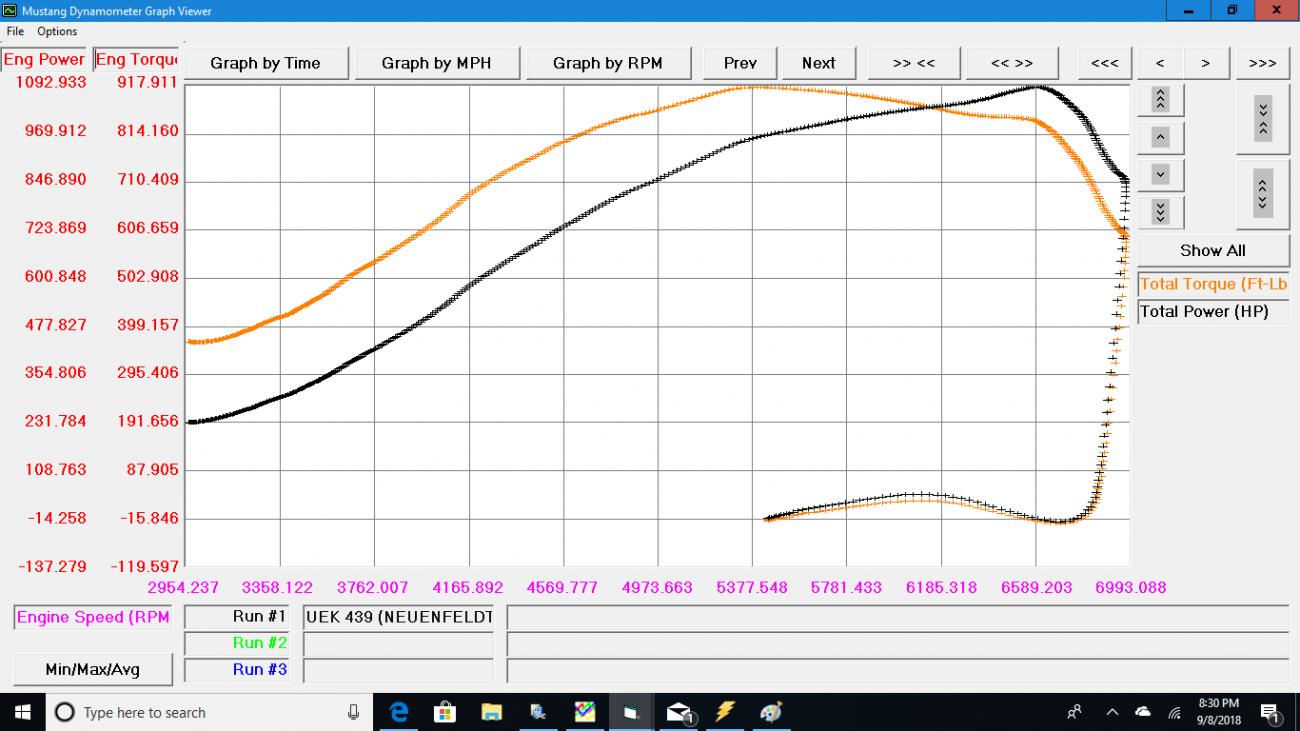

I see I haven't updated this recently. I made it to the local dyno and had some time to creep up the power. at 22psi it made 1090rwhp on a mustang dyno. it had a hard miss at 6700rpm and was still going up so it likely has a little more at 22psi. that is right inline with where the math says i should be so all is well. At some point the 62's will run out or the smallish t3 sized exhaust housing will hurt me.

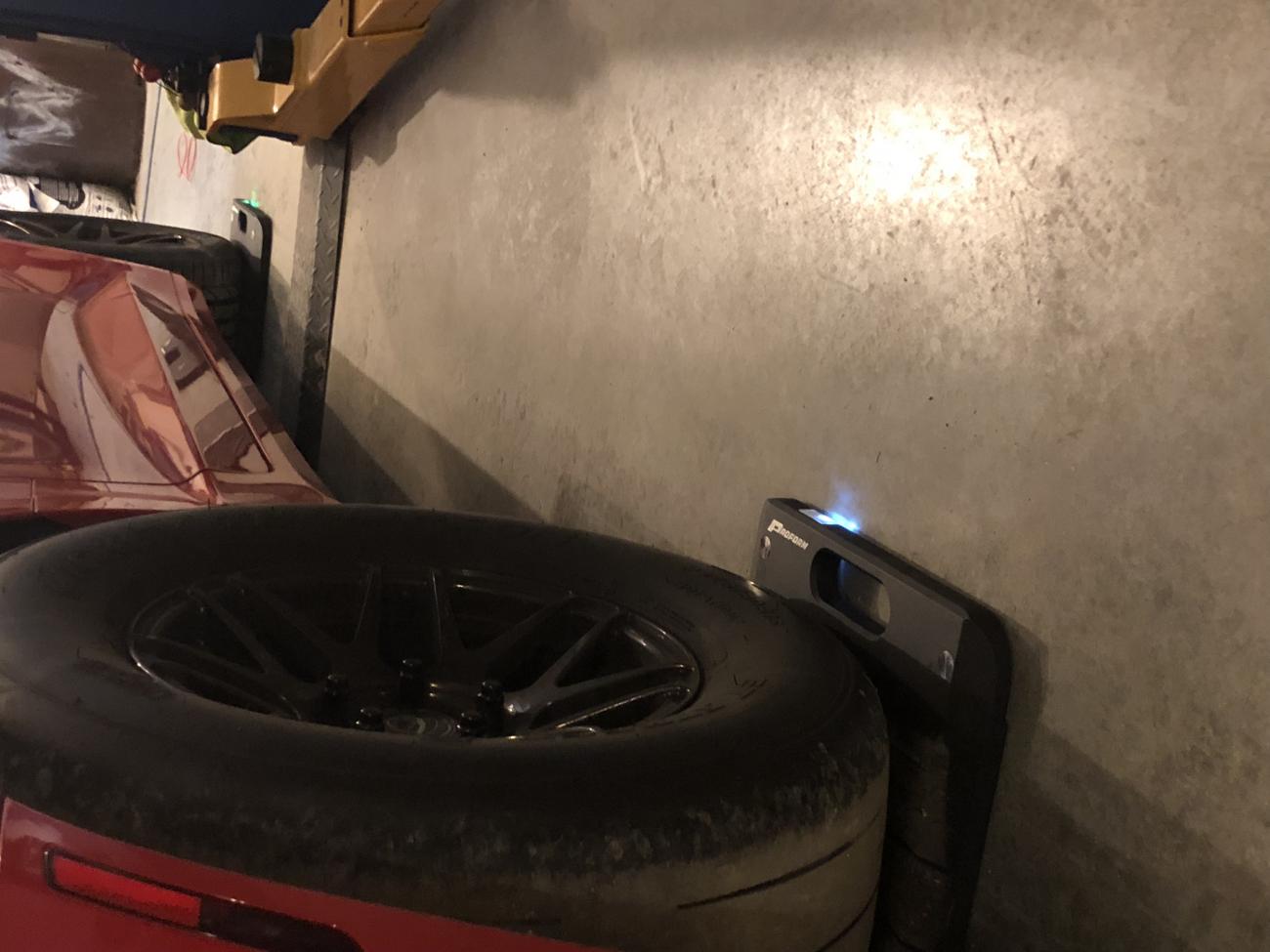

I got some scales. Street trim is 3670lbs and max effort drag strip trim is 3466. Add 180 for me to those numbers. Not too bad.

Pretty good weight considering the extra fuel weight and the weight of the twins

yeah, the twins, scavenge pump, intercooler, charge pipes, bov and wg's, steel driveshaft, bmr stuff, surge tanks and pumps... all add weight.
I wouldn't be surprised if I found another 20-30lbs in small items but I am about out of easy weight loss.

I just realized I do not have my back set in. those number actually are about 30lbs higher than I posted.
