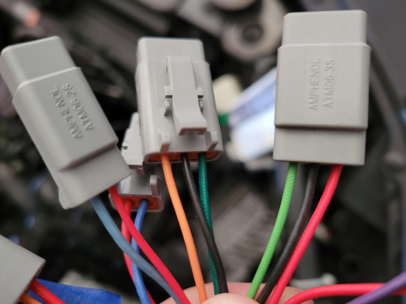

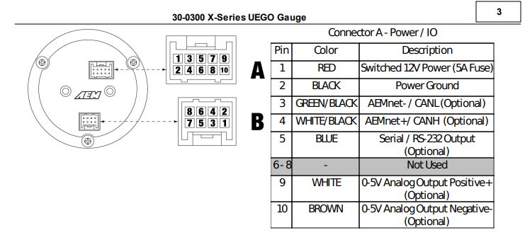

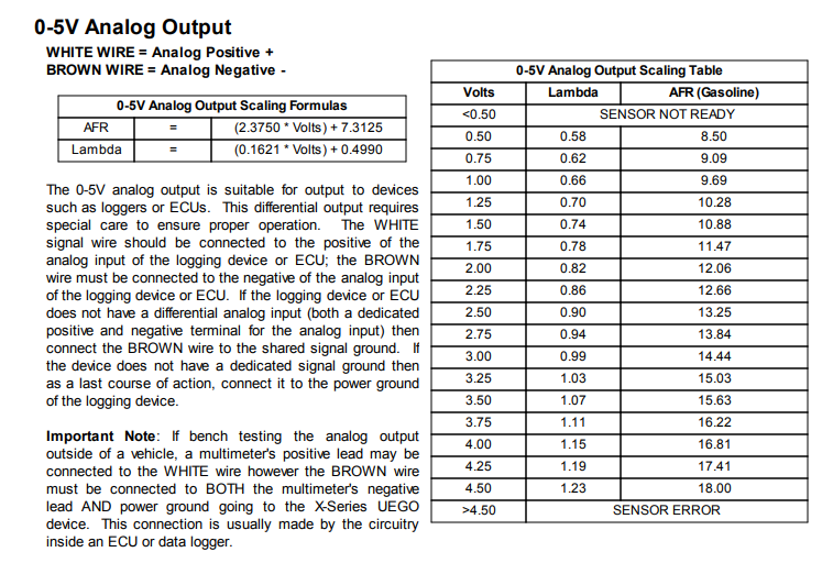

Didn't get anything done with the reflex install yesterday, but I did start looking at how to wire in the wideband.
My best guess on the AEM wideband, the white and brown wires from the gauge can be wired to the two leads on the reflex. I'd like to get someone to chime in that knows more... but best guess based on the documentation from Motiv, AEM, and the THPSI page:
- the AEM brown negative would go to the reflex black wire
- the AEM white positive would go to the reflex dark green wire
I don't know how else it could possibly go, but the terminology used in the AEM documentation regarding the white and brown wires is a little confusing.
