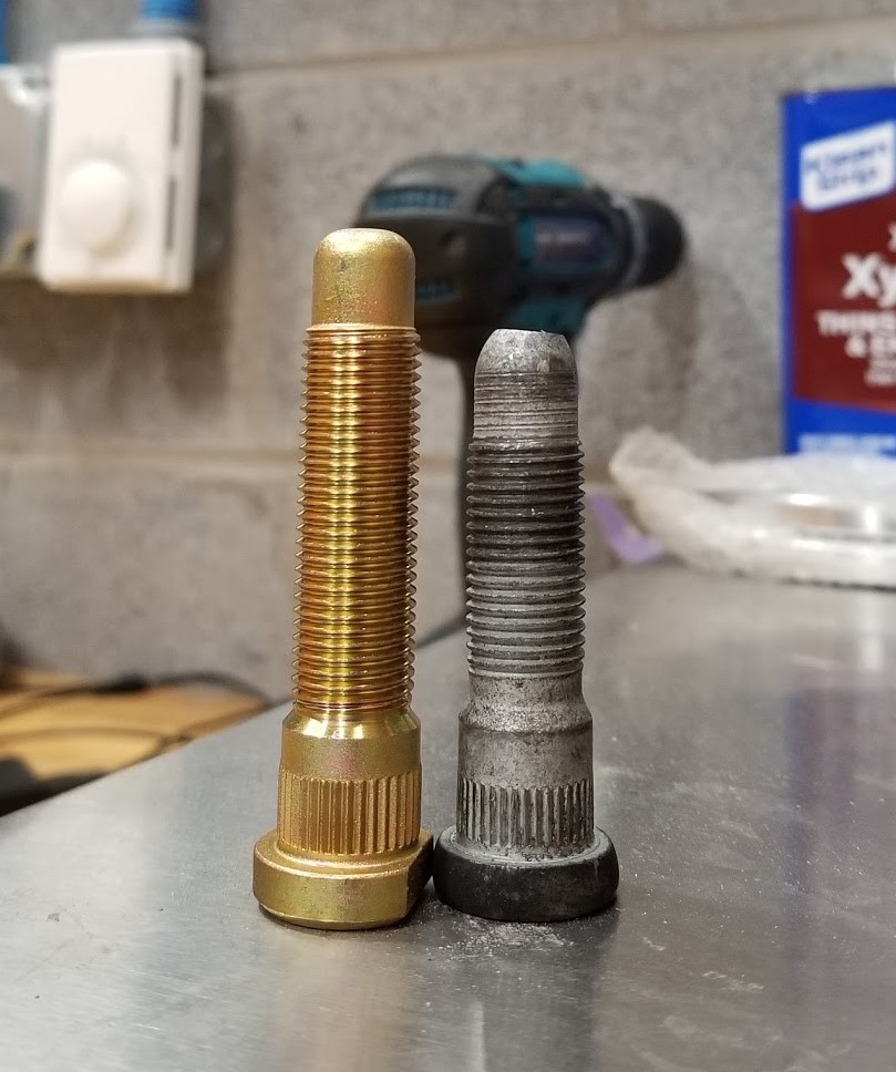

Speaking of studs, L to R, an ARP next to stock, MSI on the right and a PTC on the bottom. The PTC is made for a F-250 etc, so it's a probably not going to be used by me.

That is an ARP 100-7736 (1/2" longer thread & overall). The -7737 are 1" longer thread & overall if you need to go that route.
Also, as you can see from the stock stud that was used with a stock wheel, there were 9 threads engaged or just below 14mm engagement which is the minimum I shoot for, but, lots of opinions on that.

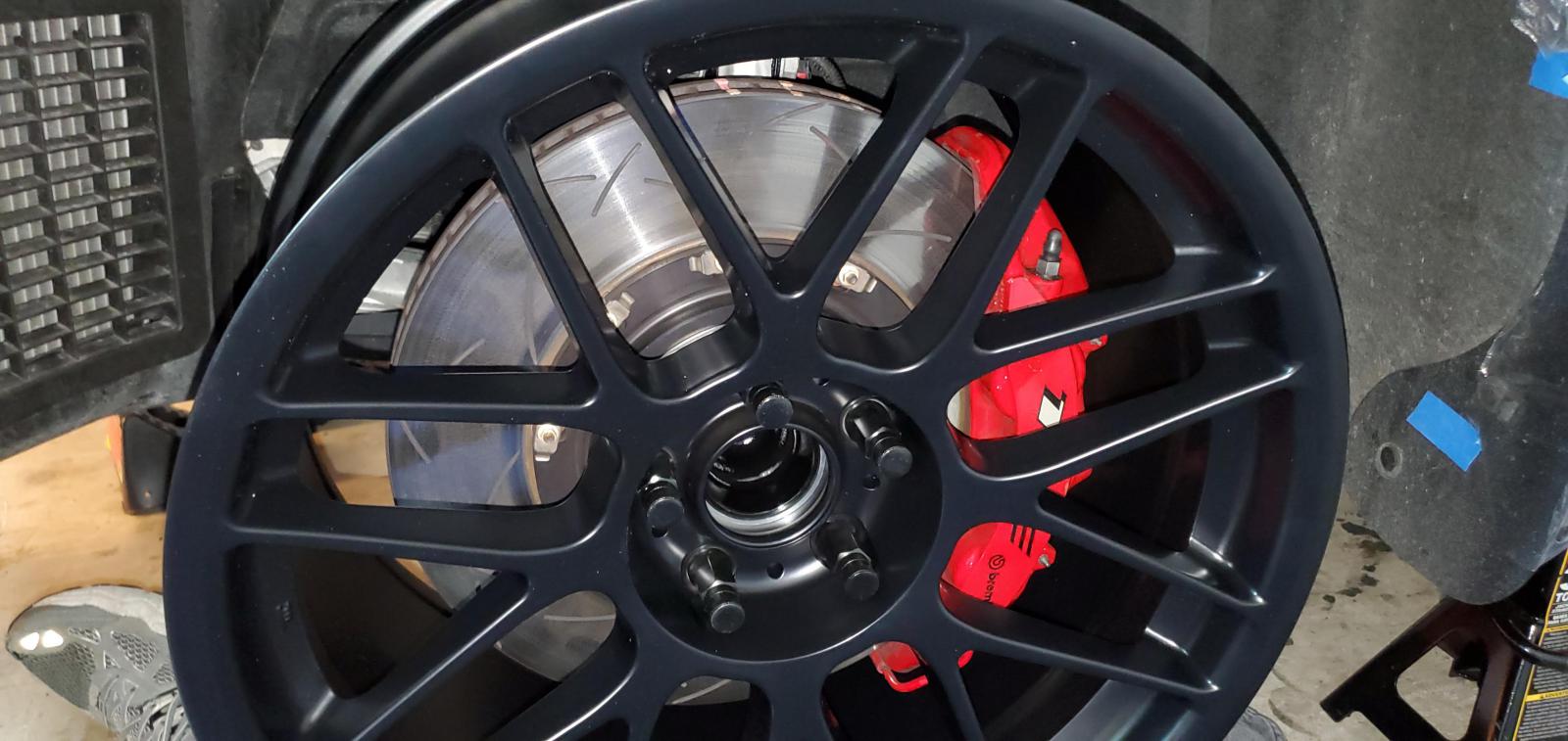

Test drive today with the Provoste 305 square setup with G3R tires. It does poke a little but makes it look even more race car
