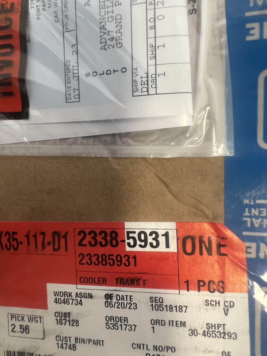

UPDATED Trans Cooler to Be installed
Ok guys and gals,
Last time i was at the track, my trans temps got to 250 degrees due to the excessive heat and THAT is NOT good. So I had AMP order me a TRANS cooler for a 10 speed auto that comes standard with the ZL1.
That trans cooler will bolt right in place of my stock one (camaro SS version). THIS ZL1 version is a 14 ROW cooler design compared to the SS version which is a 10 ROW design. Also the Core Tubes are .75 wide compared to the SS version .69 wide core tubes. Also the inbound/outbound lines on the ZL1 version are .49 inch in diameter compared to .38 inch diameter for the SS version. I have been told the opening underneath the bottom of the car will have to be enlarged to accommodate the larger size of the ZL1 cooler.
Will post up pics when installed
We will change out filter and fluid as well when we do this PRIOR to track day this weekend. PICS Below. Cooler is about 245 dollars.

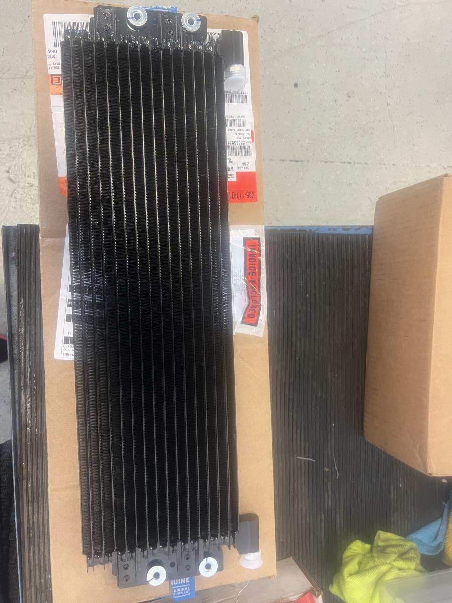

Installed A10 ZL1 Tranny Cooler
Ok PIC below is installed OEM A10 ZL1 Tranny Cooler. This is a bolt in replacement for the stock A10 SS tranny cooler. Only mod you have to do is to make the opening about 3 inches wider towards the front of the car to accomodate the larger size of the 14 row Zl1 cooler vs the 10 row SS tranny cooler.
I will let you know what effect this has on trans temps after my time trial event this saturday. The outside temperature should be in the 100's so that should be a good test. Last time out I was getting up to 250 degrees which is too hot. I would be happy to see 210-215 but time will tell.
The LEFT side of the picture is the side that is closest to the FRONT of the car. This cooler is basically parallel to the ground behind the front bumper area We changed out fluid and filter while we were at it. We used 14 quarts of MOBIL 1 ATF HP fluid at 14.25 a quart retail (11.99/qrt at summitt) and a damn 61.00 filter YIKES!!!! There is NO FILL tube on an A10 by the way so there is a very specific procedure on how to properly fill tranny (do a search).

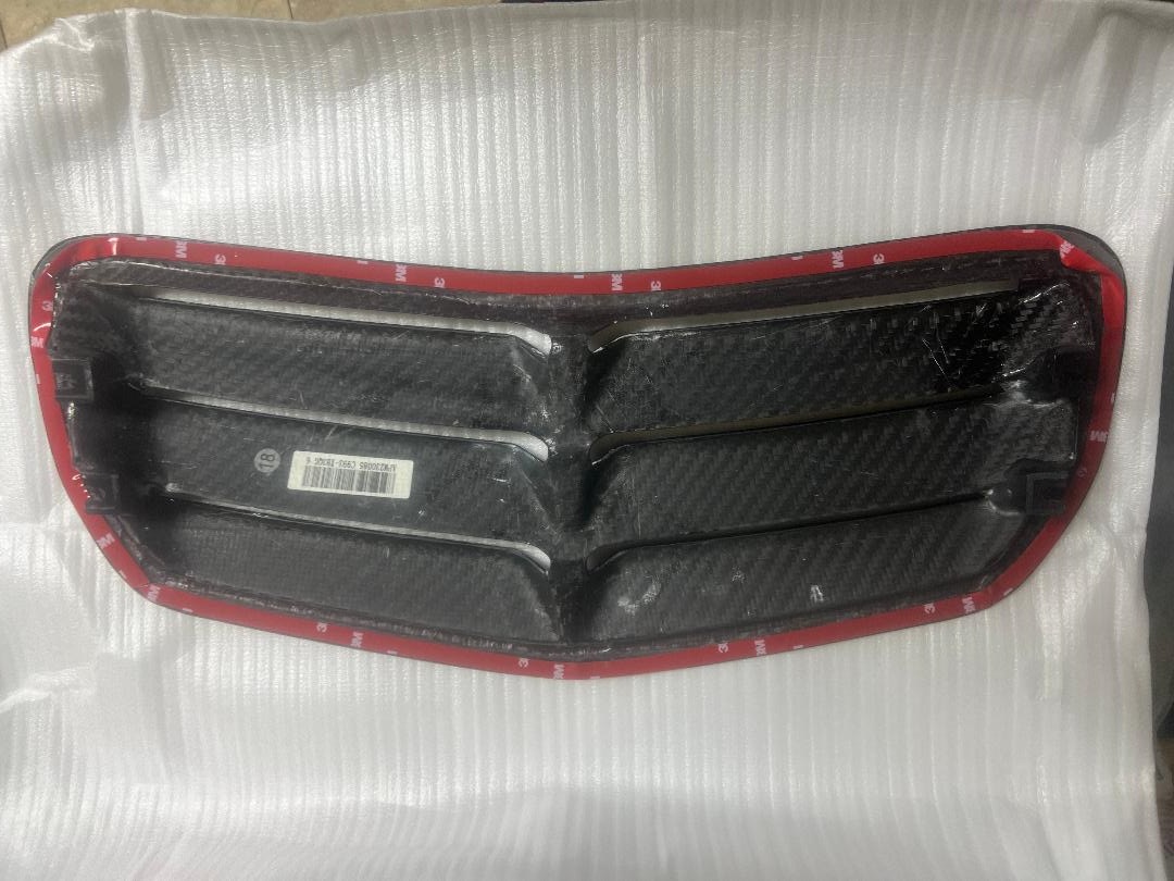

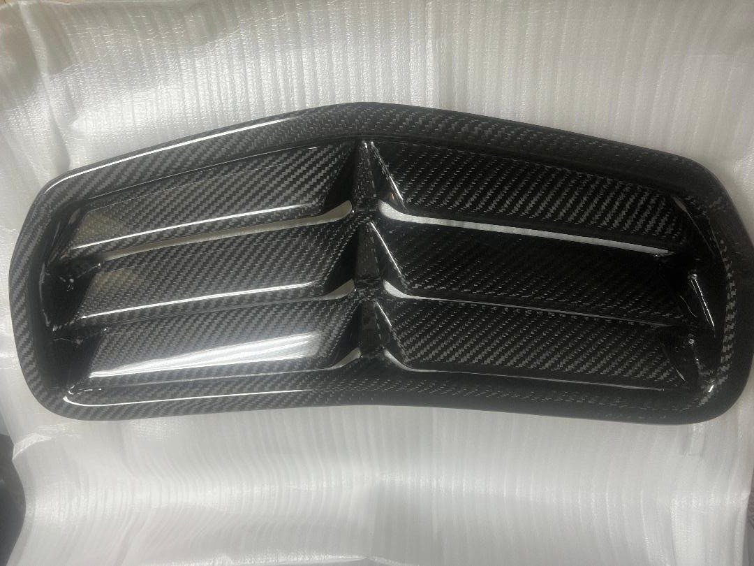

MIDDLE Blach SS hood vent replaced with TRUFIBER CF Vent
OK as I mentioned in post number 302 above; I decided to replace my stock middle BLACK SS hood vent with a carbon fiber piece that would complement the two CF vents I just installed. Here are the pics below of the top and back of the vent. I will post up shortly the vent installed in the hood. This is a EOS piece and is VERY nice.

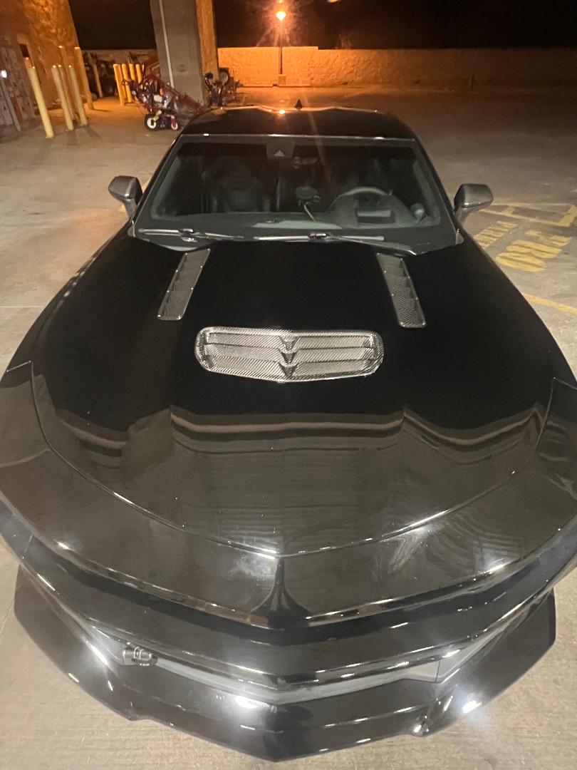

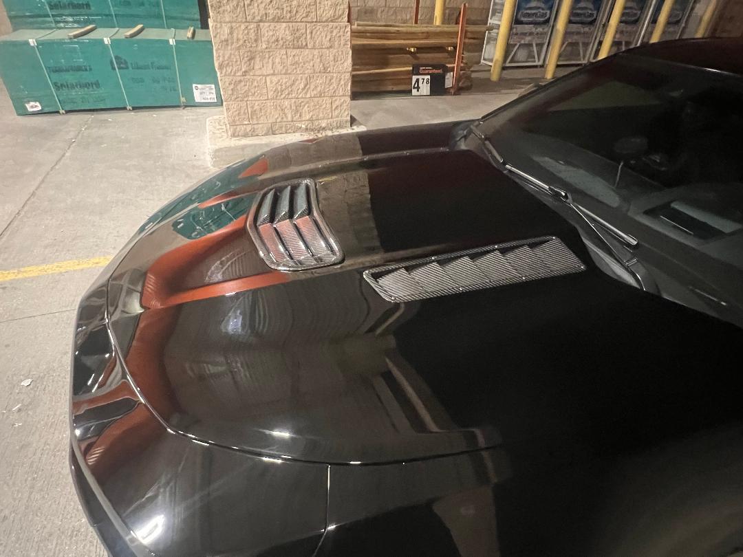

ALL hood vents iinstalled on hood of car
OK Home depot lighting sucks but below are installed CF hood vents on car
Why didn't you use the recommended A10 fluid?
ACDelco #10-4107 (#19352619) Dexron ULV Automatic Transmission Fluid
Well AMP did the work and they didnt specifically state on their invoice the exact part number of the ATF they used but they have done quite a few of these do i have no doubt it will be fine
